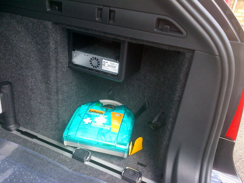

I think the TV module is in the boot behind one of the side covers. Is that right, and do you reckon it would be easy enough to retrofit one without all new trim?
A photo would be fab if possible.
Edited by lowedb
is this the tv module?
Yes, that's the beast. So it looks like an extra bracket, a cover, and cut the corner out of the existing trim. very doable I reckon.
