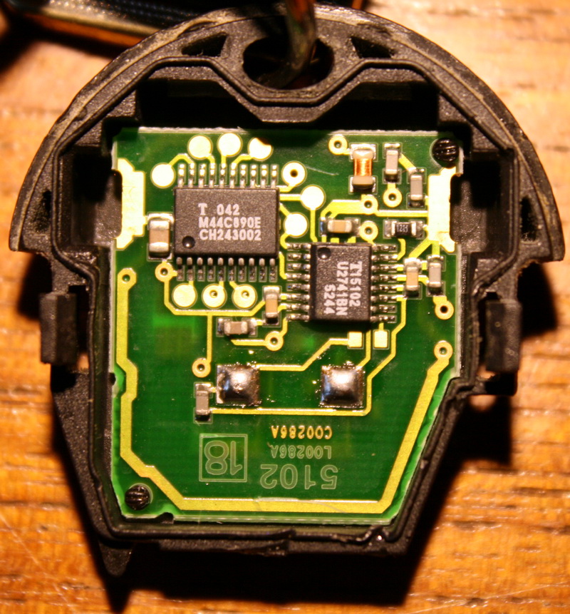

My keyfob doesn't work.
It's for 2003 fabia hatchback.
LED does not blink.
There's a missing component on the pcb , where two silver pads are ( see pic )
I know it's a quartz oscillator , but I don't know the frequency.
So will anyone be so kind and open his remote , to check and let me know the description on it ?

I have soldered 12 MHz quartz and led is now flashing , but didn't work with the car.
Wrong frequency.
So I'm only missing this part to get it going.

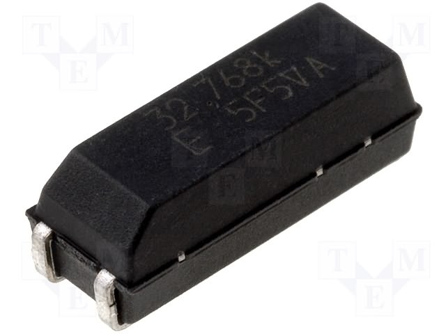

Please see pictures of what I think it may look like.
I need to know what is written on that part.

looking at that pic, there does not seem to be anything missing, the two blobs of solder i assume you are reffering to as where the crystal should go do not show signs of something coming off, they are too perfect, you may find the crystal on the other side of the boards
and if the crystal should have been there you would have found it inside tha case when you took the keyfob apart surely?

It looks like that after my soldering.
Someone probably opened it before and removed that part from casing.
Remote wasn't working when I've got this car.
