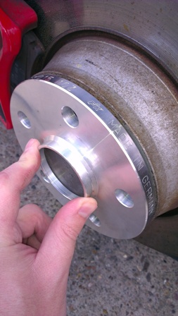

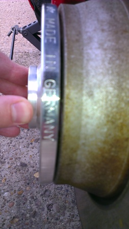

I'm using FK Spacers and the fronts fit fine, but the rears don't butt up to the hub (there's maybe a 5mm gap, both sides same).

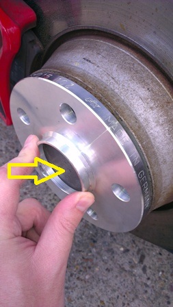

Problem appears to be that the arrowed part of the hub setup extends further out on the rear.

Looks like you need a thicker spacer for the rear so the bore is deeper.
Damian @ DPM Performance
Hubcentric 15mm spacers are the best bet. Better still I know someone who is selling some ;)
Correct - not all spacer designs will fit the rear hubs.
Not true - I have 8mm H&Rs that fit fine on the rear.
I have 30mm (15mm each side) FKs fitted on the rear, I believe this is the min?? bolt on separately and then use original bolts for the wheels. I had mine fitted by Awesome GTI, when they done the springs

just for completeness i can confirm that the fk 15 mm (i.e. 30 mm on axle) bolt through spacers do fit on my 58 plate vrs rear hubs.
