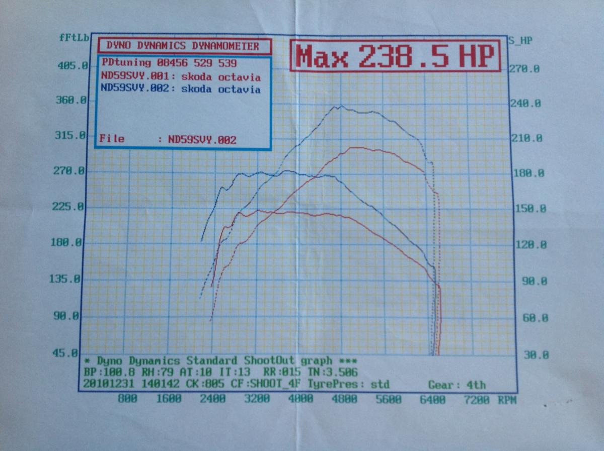

Also added the last Dyno run, just a standard car with a stage 1 remap.
It was also running 95 unleaded at the time.
