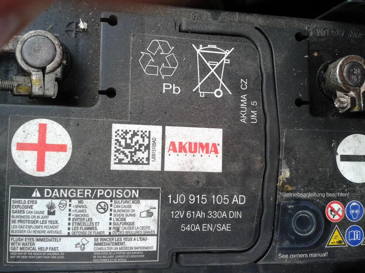

I think mine may be original also - its an AKUMA CZ UM5 part no 1JO 915 105 AD - but I cant find any date code. The 'magic eye' is almost black with a feint green just discernible. The Kwik Fit check reckoned it was OK though, so it may have already been replaced.
Still you are right, the recent batteries are more powerful and may give much better performance and are not that expensive.
:) Yes, Flyerphil! That's the original one! This is the one I had on my car and I couldn't start the engine anymore yesterday morning! Just got rid of it! :)
Edited by Octavia MK1
Yup, same as mine. I replaced it at almost 8 years. It was still starting (usually) but I had one or two moments where it was a little worrying. Time to replace. £62 from ECP with the forum discount delivered to my (neighbours) door.
