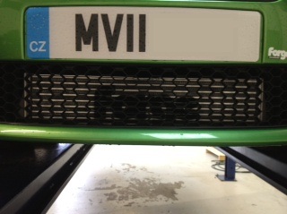

Returned home from a second 280 mile round trip to Forge Motorsport to collect my car with their uprated intercooler which will be on the market at a later date.
The IC looks fantastic through the front lower grill, the car feels like it just wants to pull and pull right the way thru the rev range, on there testing it achieve a gain of 11bhp & 21 ftlb torque from the standard engine which is very noticeable when behind the wheel!

few pics ive managed to upload, not the best pictures but hey :rofl:

Must admit, having FORGE in massive letters is a massive deterrent for me. I cant stand any "look at me" modifications on my car. Its embarassing and shouts MAXPOWER at everyone.
Like the look of it mate, looks spot on for size, but like Si said, whats the increase in size?
Also I would have it without the forge on it, but if it came like that free I would t complain... I tell a lie I'd spray it all black lol!
I will get the dimensions in the week sometime
The IC came with the forge sprayed on it already so I can't complain, I like everything about it, size and everything is perfect, it fits snug between the plastic cowlings either end of the cooler without any cutting which is a bonus too.

Maybe something worth passing onto forge. But I would say that the FORGE lettering needs to be placed more central when you see it through the honeycomb grille.
Edited* spell error
Edited by Wilko251088
Edited* spell error
More central..it's slap bang in the middle :S
I think he means slightly higher
Correct sorry for not being 100% clear, just lifts it off the bottom of the grille and more vertically central.

ahhh I see, no one ever really gets down level to see the IC so looking at it from a standing position it looks bob on
