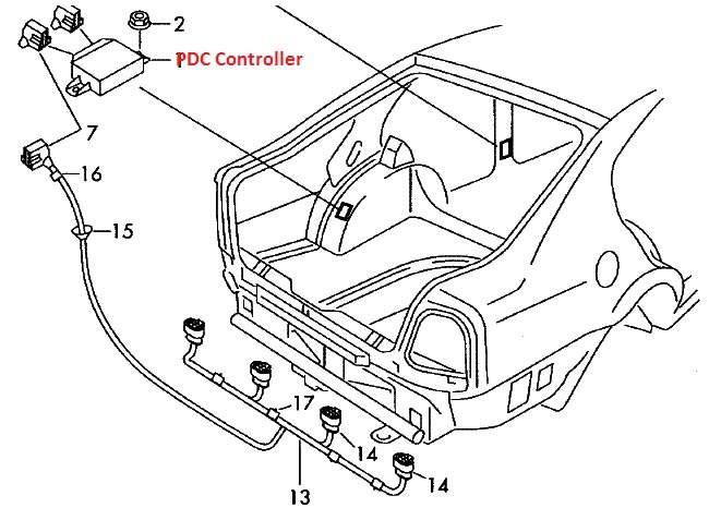

When you engage the Reverse Gear, a "CAN Message" asking it to come ON, and when the Gear is disengaged, another Message to put it OFF is sent over the CAN Bus (Cable) that is connected to the Controller from the CAN Gateway (Master Controller). These messages are exchanged over the CAN Bus from the Gateway to the Controller over a pair of Wires (Cable). The Parking Switch you are referring to is connected directly to the controller to activate/de-active it without having to use the CAN Bus. Since the Switch activation of the PDC works perfectly, it would most probably be a problem with the CAN Cable that is connected from the Gateway to the PDC Controller as it seems the Messages are not reaching the PDC all the time. VCDS would come in handy in confirming this.
The Controller is easy to locate, which can be found inside the trunk, on the Passenger's side:
