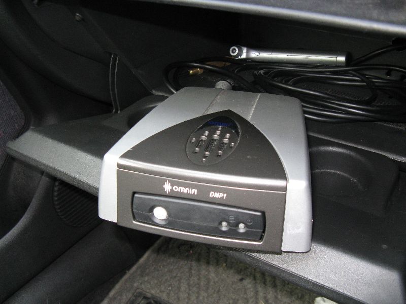

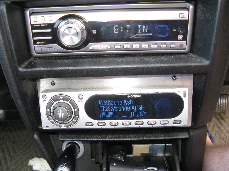

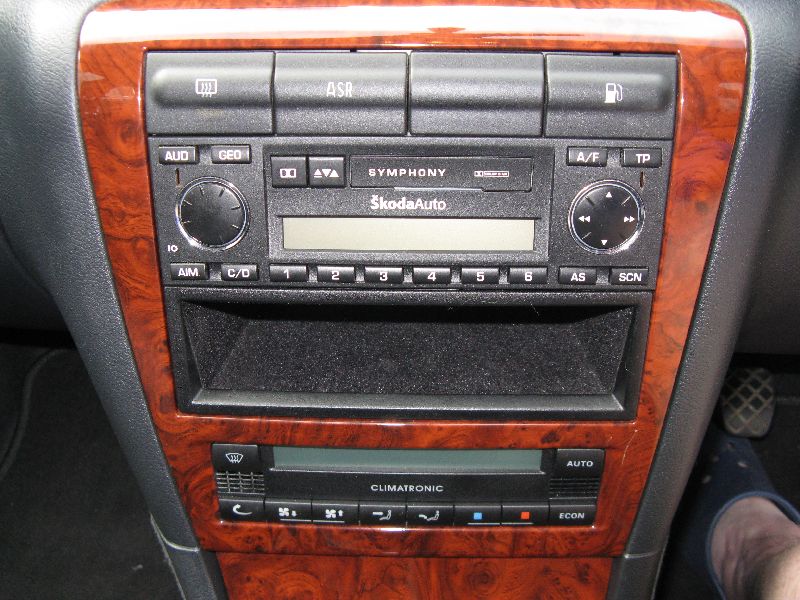

Here are the pics
The first is the actual mp3 unit that sits in the glovebox and will fit in the octy glovebox.
The second is as it is in my car at present. A mate made me a plate and brackets and that is screwed to the cubby hole of the cavalier.
And then the fascia of my Octy.
I seem to recall I have a brand new alpine cage somewhere in the loft which I might be able to put to good use if I cannot use the cubby hole on the Octy.

That trim is not original, it might from the L&K. You should be fine without any adapters though.
The car isn't a black hatch by any chance?

That's a twin din sized hole with stereo and cubby hole removed

No. silver hatch.

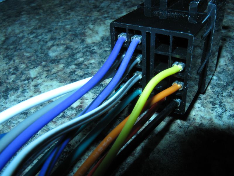

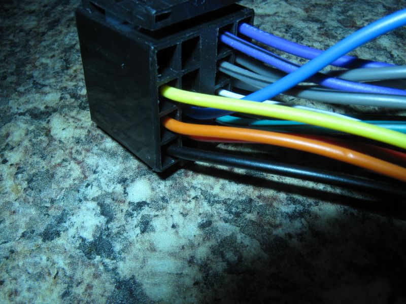

Well I bought a harness adapter mainly to keep things tidy as I will need to wire in the omnifi, and I used a terminal block before.
I've just tried the harness and it powers my radio. The radio will come on without the ignition being on, but so it seems will the Symphony.
Unfortunately it now needs a code and I don;t have one. I read here that if it was recognised by the ecu it would just work?.
The harness has a blue line loose terminated in a bullet socket, but the yellow and orange do not seem to be swapped over.?

If the symphony stereo was originally from the car it should leave the safe mode without a code after being switched on for a while.
You'll need to swap the red and yellow wires if you lose the set radio stations and settings I didn't have to when I fitted mine, for the radio reception you will need a power injector.
The terminals will come out of the plug, you can get proper terminal removal kits or just find something small enough to push in the hole above the terminal to push the securing lug down.
