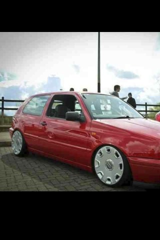

These are the wheels ime thinking for the vrs, pretty rare considering there are only 4 sets in the uk.

Sorry bud if ur wanting rare^^ they have been dun on a lad on heres SE fabia
x12_tag's fabia ^^^
x12_tag's fabia ^^^
and antvrs has the older style audi monoblock/winters. . and has for years.
From what i have heard there are only 4 sets in the uk, and a lad i know ownes two of them. I am glad they have been done tbh, because they look sweet. Thanks for pointing me in the right direction
Bottom half of the page m8 ^^ they do look sweet tho ;-).. doubt there are only 4 sets tho bud.. the word "rare" in terms of wheels is over used
No your right actually, it is thrown around alot, just going off what I have heard, thanks for the link, cant wait to get em tbf. Just need to sell mine now, but its useless on here as there 4x100 and 15's lol
