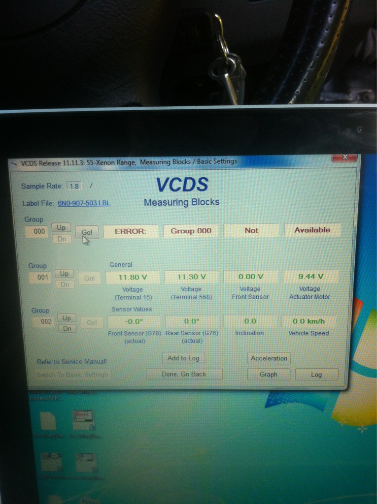

This is what readings i got when i did measuring blocks, however when i plugged it in again later the rear sensor read 30.7 :S tried following the instructions to adjust the lights off the rosstech website but it wasnt happening :S my lights don't move at all when i turn them on for the first time :/ reallly confused.

About the readings, move the mouse pointer over the Value reading box and the allowed values will pop up.
