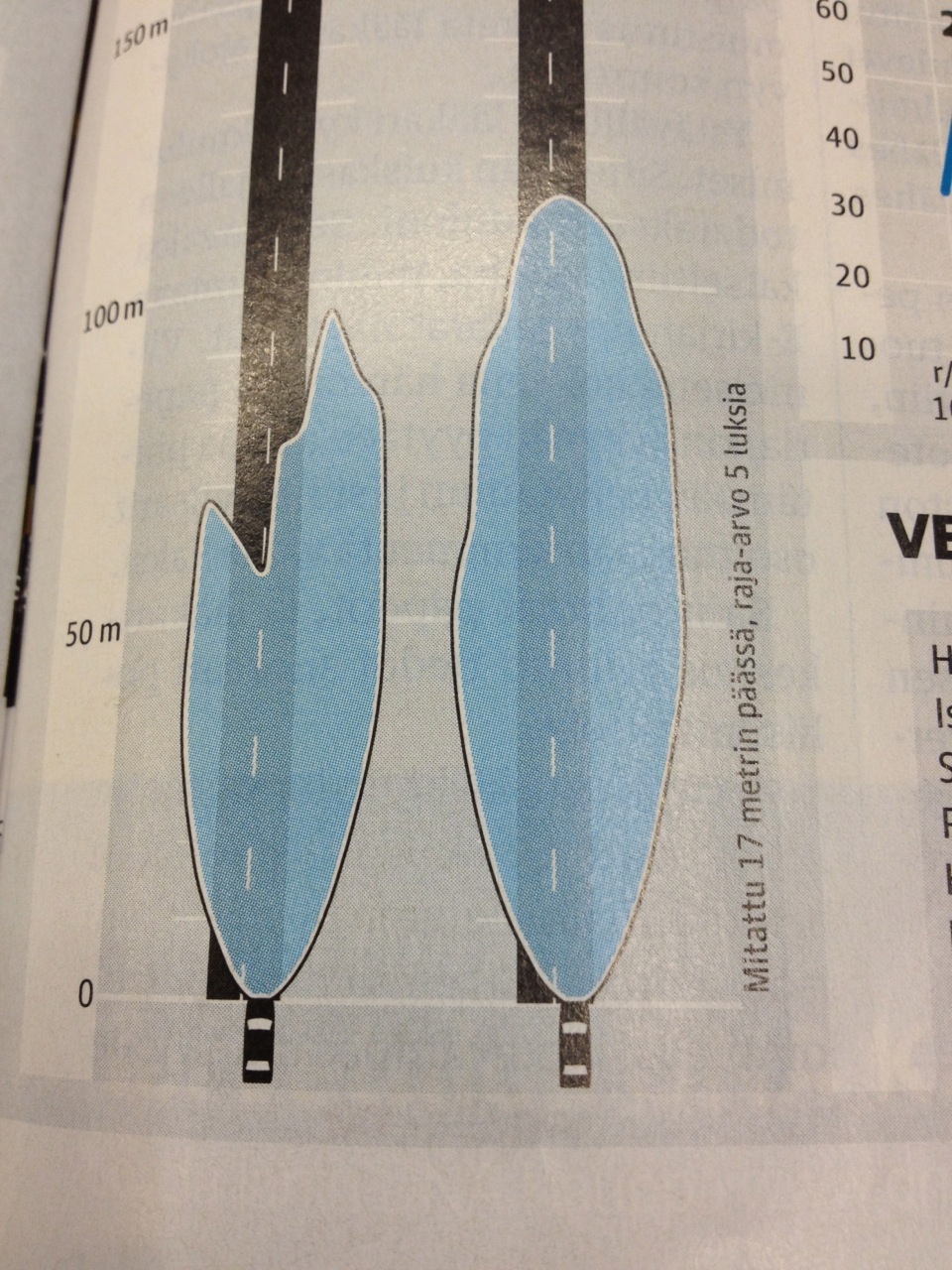

If the Superb bi-xenons are anything like the ones on various VW's I've been in, the high beam is terrible. Sure it's wide and bright and evenly lit, but it's so short it's dangerous. Most German cars seem to suffer from this illness nowadays.
I don't remember which car this was, but it's from a finnish car magazine a few months ago. I took a picture of the article thinking it'd come in handy some time in the future. :) I think it was the new A class, or the new A3 perhaps. Anyways, there's no excuse for a highbeam as bad as this.
