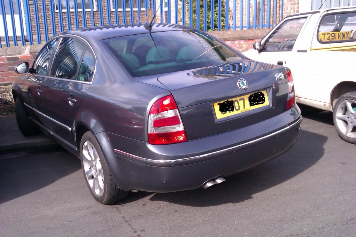

Hi,
I have been offered this car for £4,000
It has 112k on the clock but the engine has been completely rebuilt with new bottom end and the problem sorted that goes with the bottom end of the 2.0 TDi
It has had new water pump/timing belt done with the rebuild at 110k
It had a few marks around it that could do with some attention and needs a dam good valet inside (cigarettes, yuk)
I need a good solid tow car for my family and caravan and have liked Skodas for years.
I was surprised by the road tax, £195 for the year! My Renault Laguna (engine blown) was only £130
Is the 2.0 TDi a bad engine? It only has one cam, I've been told most have two.
The car is owned by a guy that fixes Skodas for a living at a independent Skoda garage in Leeds (Skoda Land) so should know what he is talking about.
Thanks for any advice

Sounds a bit risky to me. There are other Superbs available.
NO NO NO.
Don't do it to yourself, no matter how cheap you find a MKI 2.0 Superb you will regret it when the oil pump drive fails again.
OK that sounds like clear advice ha ha Thanks :giggle:
I have now read up on the horrors of the VW 2.0 TDi engine, one to avoid I think.
He said that it wouldn't do it again because the problem had been sorted. I thought there must have been a problem with this engine when new but a different part could be fitted to sort it but it seems not. I guess even with the big rebuild its just a matter of time before it does it again.
