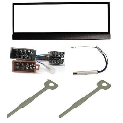

Purchased a cheapazoid kit from Amazon containing the keys, a fascia plate, connectors and aerial lead.
Link: http://www.amazon.co...ils_o06_s00_i00
The aerial "stick" is a few inches long which makes recessing the leads somewhat fiddly.

The rear of the supplied fascia plate is completely flush with no fixings and falls off. The plate could do with a clip to go in the retaining hole below the ASR switch and keep the unit pushed in:
(lens flare!)
Works, but is untidy. Did I bodge the install, fitting the parts incorrectly? I'm wondering if I need a new cage. I remember reading here you can get a Skoda-supplied fascia, so need to dig out a part number (if anyone has one fire away).

U fit the fascia 1st.. then the headunit surround clips on top.. holding the fascia on like so....

U jus need the plastic surround (fascia) that comes with the cd player... if u dont have it u can buy them from the cd player manufacturer or ebay im guessing.. jus a black plastic surround (see my pic)

Thanks Matt - easier said than done. Must have been left on the Alfa. So this is what I need
Incarexpress seem to have a number, but not for this type :/
Hit upon Pioneer parts store in the US. Enter model of unit. P/n is CNS6935 and there are a shed load on ebay. Hoorah!
