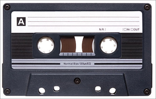

What's a cassette tape? :hi:
It's a new-fangled thing designed to replace the 8-track you've got. :p :p :p

These, I believe, are a new replacement for Blue-Ray.
Equipement will be in in the shops in time for next Christmas. :giggle:
