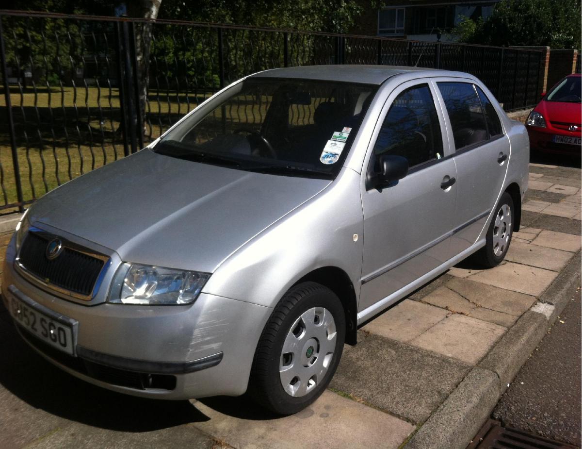

ye it was a bargin had a mate look under it the other day and he said the engine was spotless no leaks or the usual
im going to add a few pics but since these pics was taken ive sprayed all the side trim black and cleaned the car and engine up
i have had to do some work on the car but so far nothing serious
