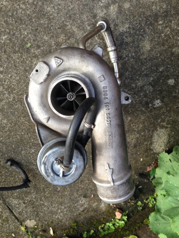

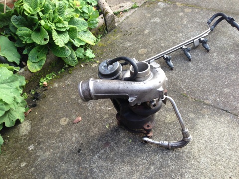

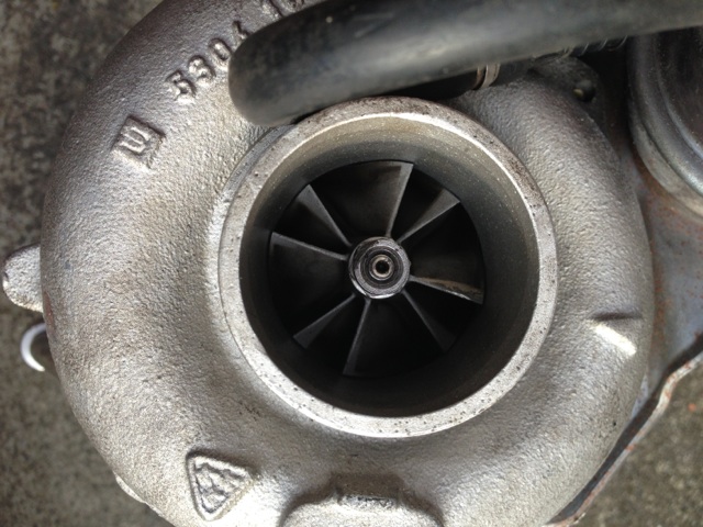

Well guy has sent me some pictures of turbo,some things don't add up,no plate on the turbo,there's usually a small square plate rivited onto turbo with part numbers,also the pipe that comes off the actuator is attached to the side of the turbo,where does the pipe from the n75 go then,think its a cheap copy,what do people think?
post the pic mate
I would post some pics,but the guy text me the pictures and I have no idea how to get them on here lol
Another pic
Just wondered if anyone had a look at the pictures to see if its a real ko4 turbo,turns out the pipe on the actuator isn't connected to anything,just lying against turbo.
Looks like a copy the tag should be blue and why is the actuator hanging off ??
I noticed there was no tag,still can't see the actuator hanging off,the guy that's selling it is a vw mechanic and he has assured me its genuine,I'm going to have a look at it,anything else gives it away as being a copy?
