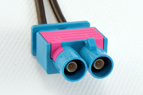

Having had a few moments to take the Columbus out and have a good look, it turns out to be the pin in the FAKRA connector that has snapped off inside the plug.
I have the pin and will try soldering it back on as my Columbus FAKRA connectors do not have the sleeve surrounding the pin (see picture of similar connector) which probably explains why how it came to get snapped in the first place.
If I can't solder it back on, it looks like it will have to be opened up and a new double FAKRA connector soldered on (if I can find the right one).
Could I use the ones with the internal sleeves?
