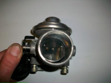

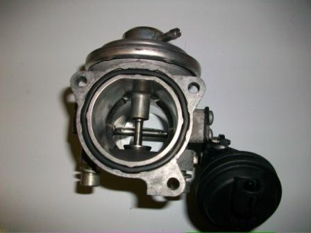

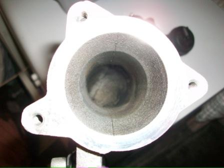

As above, let it soak in diesel or kerosesne if you have any. I used an alloy wheel spoke cleaning brush on mine. Then once everyone had gone to bed I ran it through the dishwasher.
Its easier to receive forgiveness than permission.post-72179-0-71674900-1351085809_thumb.jpgpost-72179-0-88555300-1351085821_thumb.jpgpost-72179-0-69270300-1351085831_thumb.jpg
Love it
Did you use a lemon scented tab in the D/W ?
( or was it just a plain one ? )
Almost. Actually it was 2 fairy active bursts. haha.
