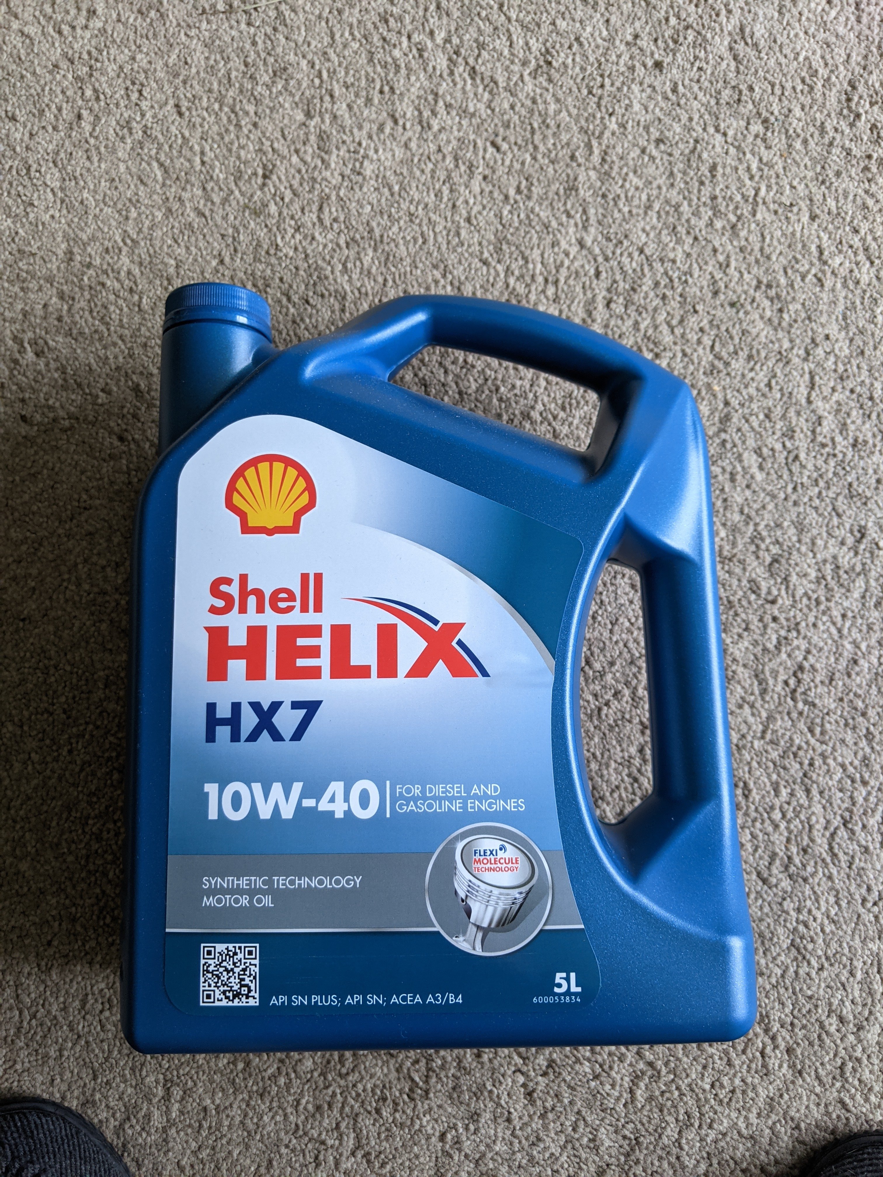

Did I goof?
The Shell website suggested this was the correct oil for my MK1 vRS.
It meets VW 502/505 spec too.
However, no one in this thread seems to be using 10w40, or HX7 specifically!

I’ve only ever used Quantum LongLife III 5W-30 from TPS. They sell 5L for £19, and when on offer for £13. Both used in my VRS and the diesel. I do an oil change every 10k or 1 year which ever comes first.

On 25/05/2021 at 07:43, nutters_uclan said:
Did I goof?
Hmm I don't think that oil used to be to spec, maybe it's changed in the last few years.
It'll probably be fine but when there are better oils available for £20 (or less if you're lucky to be able to buy from TPS) then I'd use one of those.
