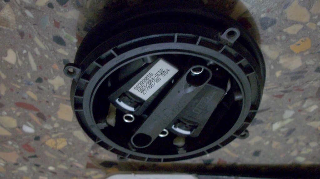

Does anyone happen to have a pre-FL wing mirror hanging around so that they can get me the part number off of the motor assembly?
I am assuming it is the same as the one Vauxhall use and also on Mk IV Golfs. Mine are getting to the end of their life, and I am not going to replace the entire wing mirror assembly as Skoda don't seem to list just the motor separately.
I know on a previous Vauxhall I managed to get just a motor assembly, so a part number or any identifying makers marks would be appreciated and I can get googling.

but I think there is a part number on the back of it that isn't shown in this picture
I just took mine off last week for some servicing, don't remember if it was the LHS or the Right but I hope it helps. The Part number seems to be: 983/004-632.
Superstar!
