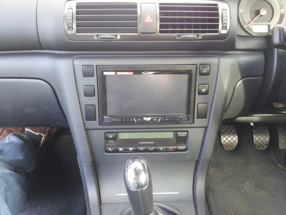

I've just done the same with my 54 Superb Comfort. I bought the Pioneer AVH-4400BT at just over £300 - not bothered about the Multimedia capability but wanted something with the Bolero/Columbus feel. Very impressed, you don't need any facias or cable adapters, etc. as it's a direct fit once the push tray is removed - only thing is you lose use of your steering wheel controls as there doesn't appear to be an adapter available for our cars - i've asked on this forum without sucess for a solution.
I'll post some pictures if you like?

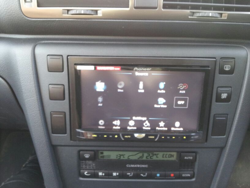

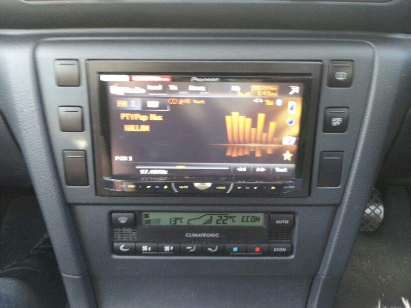

Sorry for not getting my pictures up earlier, as i said earlier, and the others have confirmed, no facias or adapters are required - was a direct fit - only issue was that i believed what i was told over the phone (and from their website) where i bought my stereo from, that the steering wheel remote adapter was an option - only to find that there isn't a compatible one. See my thread: http://www.briskoda....p/#entry2960923 Basically if your plugs in the car are as the ISO layout picture then the adapter does fit, if it's like my plugs from my car, then i'm afraid it doesn't.
Edited by MarkTB
Hey can you post picture when its turned on?
Will do later on. :-)
Photos of my stereo switched on (and in main menu) as requested :D:
Tnx!!!
