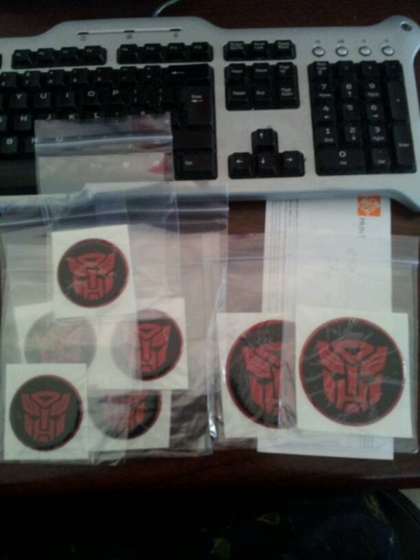

Look what came in the post!
Now how the hell do i fit them.. Haha!

so does anyone know if they are hard to fit?
Glad they turned up elliot
Should be simple to fit.
Both front and rear badges are fixed on with super sticky foam stuff.
You can saw through it with fishing line or a credit card and just prise it off.
A bit of heat from a heat gun or hair drier will soften the glue and make progress easier.
Then you just remove any remainder, clean the area throughly and stick mine in their place.
The alloy centres are a different kettle of fish but just as simple.
remove the centres, soak them in hot water to clean and soften the glue.
Prise the OEM metal badges off, dry, clean, and dry again.
Stick mine in their place and put them back in your wheels
The adhesive is pretty strong and i've run 2 sets of alloy centres with no additional glue and they've stayed fixed with no problem
Although i have heard stories of people not taking time to clean and affix properly before doing motorway speeds and the grill one comin off flying up over the bonnet/windscreen never to be seen again :)
Hahah! Ill make sure to do everything you just said then :) and what about the steering wheel one?
Once again, thanks a lot mate. Well chuffed!
OEM steering wheel badge is part of the airbag assembly and can't be removed so replacement has to just be stuck over the top
