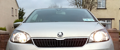

Fitted the dual element bulbs this afternoon. The second bulb fitted did not light the parking light element initially. Inspection highlighted that the contacts on these bulbs are a single wire, whereas the Skoda originals and the single element version of these had the contact wires turned back on themselves to form a double wire contact. This means that the contact area is not as wide, so I aligned them and pulled them out a bit for a springier contact and that did the trick. Here they are partnered with Philips Extreme +100. Happy.
PS. The original Skoda installed running lights can be seen in the first image of my post #22 on the previous page to give some indication of the difference in colour temperature.
looks good, headlights will be our next upgrade :)
