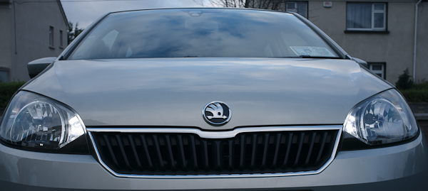

before, yellow looking running lights....

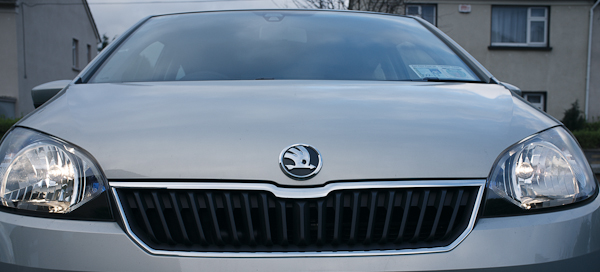

after white "LED" look running lights...
Uploaded with ImageShack.us
note: these are replacement bulbs, not actually LED's so no errors occur, they are "blue/white" which gives the LED look, instead of the soft yellow of the standard bulbs.
sorry for the crap pics from my phone, couldn't get square on to the car where its parked for equal sight of the bulbs... they are both equally bright, just the daft angle that makes them look odd :)

Fitted the Mtec running lights today, same as Sharkrider.
1) First the heads with the original running lights.
2)Then the heads and new running lights fitted. Hence no side lights when heads on. The heads are Phlips Extreme Vision +100.
3)Lastly the new running lights in normal running mode.
