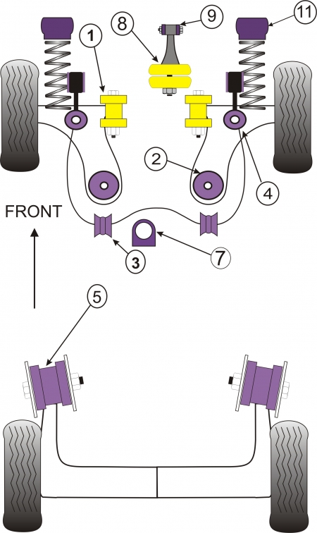

But ive been looking for a kit that includes everything for one price that I can just buy for a reasonable amount.
Like everything in this image.
well i done my front wishbones, dogbone mount and rear axle bushes and cars solid, you might not need to do all, but i guess it's a matter of choice, just make sure you get new arb brackets cause i've seen a few thats been pig to do, and been sitting off the road till parts arrived
I'd rather just do them all and know they are all good! I know itll cost me but I have a spare subframe and wishbones so I can fit it all and just throw it up.
What are the anti roll bar brackets you talk about???

cant find a decent image but thats what i'am talking about, might be worth replacing, but i would defo buy new bolts
Have a look before you start. You MAY need to smash the collars off your anti roll bar (underneath the bushes) and fit the 17mm hole bushes, rather than the 19mm bushes. These collars are usually the majority of the problem. The corrode underneath, become loose and squeak like hell.
Also, you'll probably find that the kit has the ARB drop link bushes, which are NOT for vRS, only the other model Octy's.
Is there a kit that includes all the engine mount options too? Not sure...
vRS Front anti roll bar bushes are 19mm, not 17mm.
Remove the plastic sleeve if it hasn't already broken away and you won't go far wrong.
