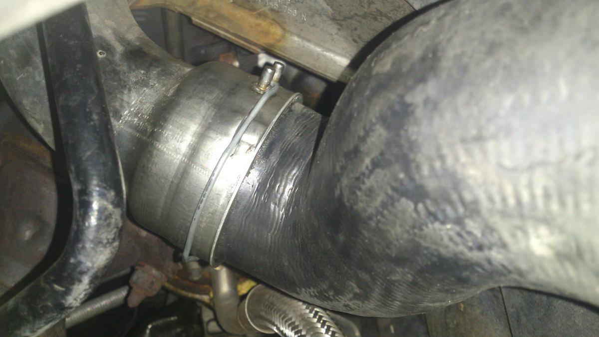

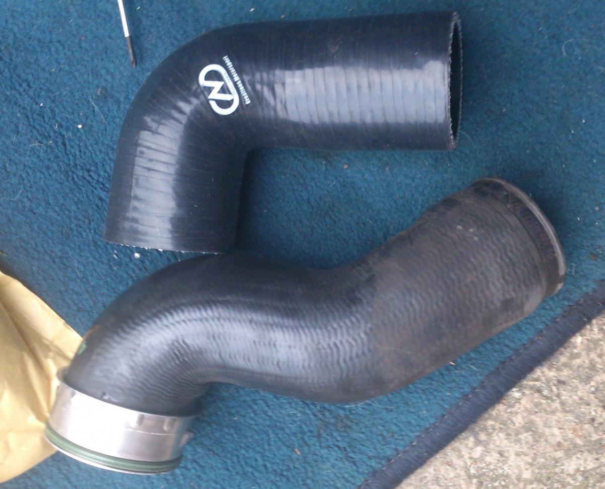

Having bought the 5 piece silicone hose kit from creations for my vRS a few months ago... I have finally gotten around to trying to fit the pipes under the wheel arch. However, I expected that the "turbo outlet" hose was supposed to replace the pipe going into the pancake pipe like so:
But evidently they are completely different sizes and it doesn 't come with the metal fitment at the top or a reducer. Has anyone tried to fit this selection of hoses?
Like in a number of other posts I have seen, the existing pipe seems quite loose, which is a bit surprising on a 2005 with 70k on the clock. So I'm debating to cut my losses with the pipe and try the updated skoda one or try one of the setups found here: http://forums.vwvort...3081&viewfull=1 .
Can any of the creations reps see where I am going wrong with this pipe? I am a bit surprised the kit comes with so much less than is required to fit it.... I can't see any other pipe this could try to replace, unless they happen to have revised the design?

That pipe is from turbo outlet to intercooler pipe on top not that pipe in the pic !!
Oh, oops, sorry! Thought they couldn't have got it that wrong when making it! I didn't even know there was a pipe to replace up there, looks like it will be a PITA to get to the bottom of but never mind.
Does it look like I've put it back correctly though? I guess I'll find out if it pops off when I'm driving... but I'd rather it didn't, especially if the circlip goes missing.

I have just fitted the Samco kit to my car, and thought the same as you, turns out that pipe you have at the top is hidden by removable heat protection. Took me and a mate 20 mins to figure out, both felt like a couple of numpties afterwards.

The turbo outlet hose is at the top at the back of the engine bay, under some heat resistant wrapping with press studs. It connects the turbo to what seems to often be referred to as the charge pipe. This goes down the back of the engine to another pipe that then goes into the pancake pipe.
The pipe I think you are hoping to replace it the one that goes from the charge pipe to the pancake pipe (behind the wheel arch) and is pictured in my first post in this topic at the bottom (the s-shaped one with the metal end). If you want to change this pipe then there are some suggestions in the VW Vortex thread posted by Silver Bullet.
