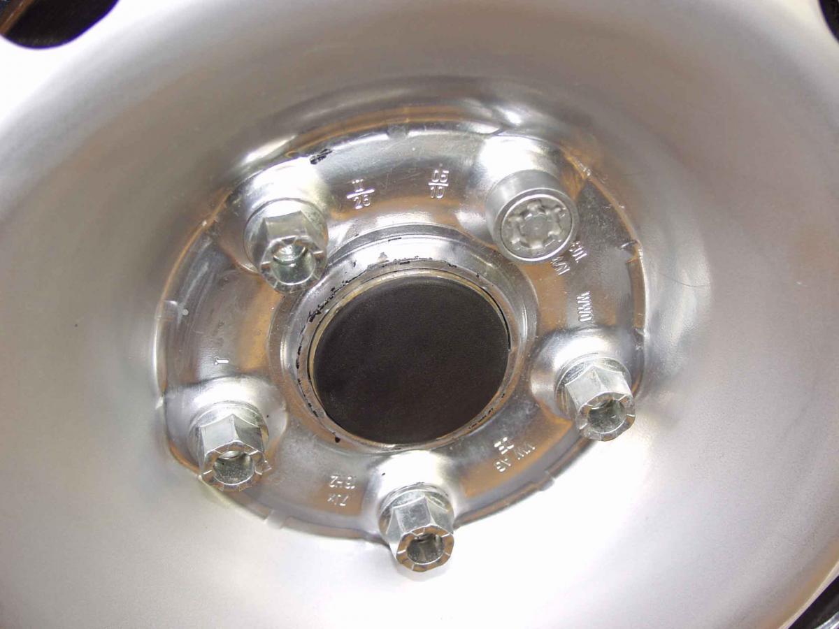

I have now swapped my 17" alloys & summer tyres for 16" Caddy steel wheels with Nokian winter tyres of appropriate profile. The latter have been very successful over the last two winters. I would like to fit some covers over the exposed wheel nuts to the winter wheels.
Can you please confirm that VW Part No. 2K06011699B9 is the correct part? Does this fit over the locking wheel nut also? (My skoda dealer cannot supply these despite them also having a VW franchise close by!)
I am using the bolts that attach the alloy wheels - is this OK? Can anyone please confirm the correct torque settings for the alloy wheels and the steel wheels please?
It does fit over the locking nut as well as standard nuts. I seem to recall that it will also fit over the nuts which also have the silver plasic covers on but I have not tried this Sorry can't find invoice for part no. They really look the part - particularly with my Storm Blue body :0)
Yes, you have the part number correct - although the "9B9" at the end doesn't seem to be strictly necessary and might stop Google finding some of the web sites which mention the part.
The Caddy centre caps will fit over the locking wheel nut, though they don't clip in place on it (they do on the other four, so the centre cap won't go walkies). They don't fit over the plastic wheel nut covers, you need to keep those stashed somewhere safe over the winter.

Yes, I used my original alloy wheel bolts, (I guess that should be ok for VAG steel wheels). The torque setting is 120nM and the tyre pressure is 0.2 bar above standard pressure.

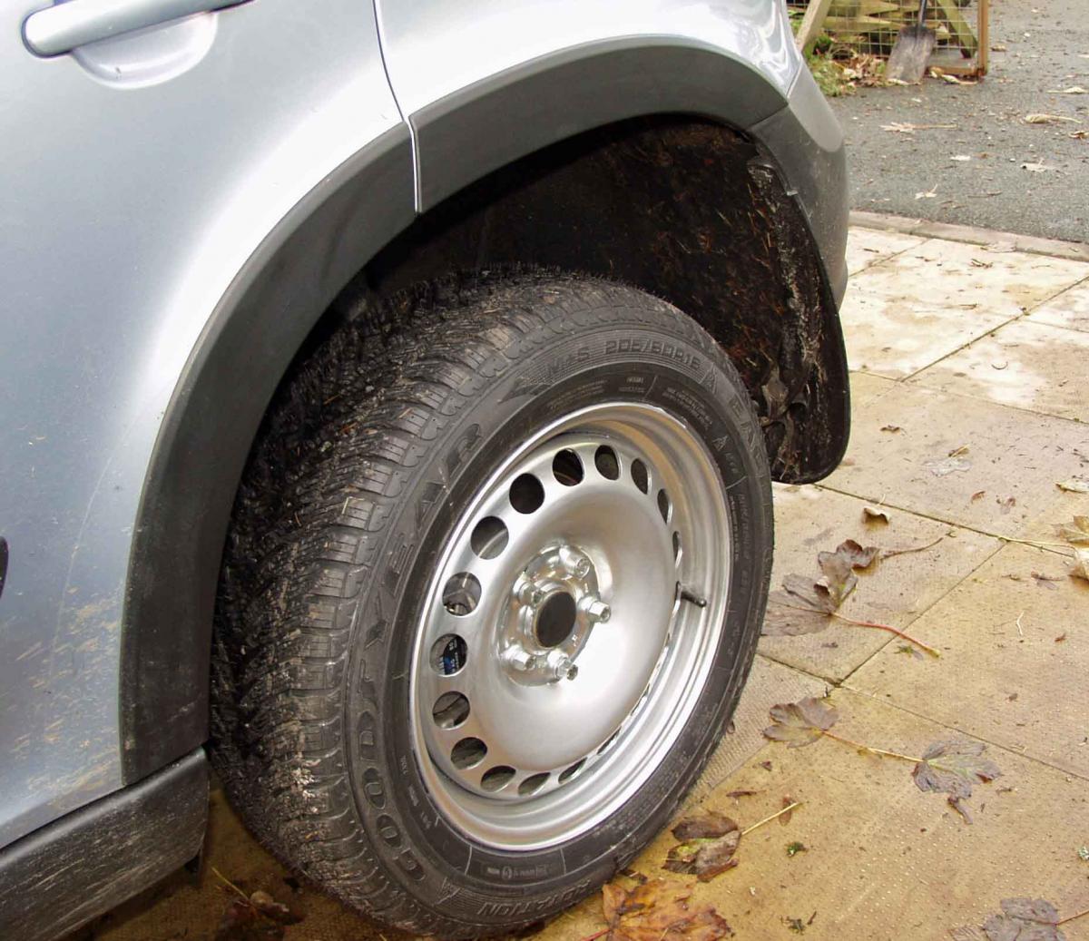

You could of course go for the "mininmalist" or has been reffered to as "utilitarian" look - see pictures..,

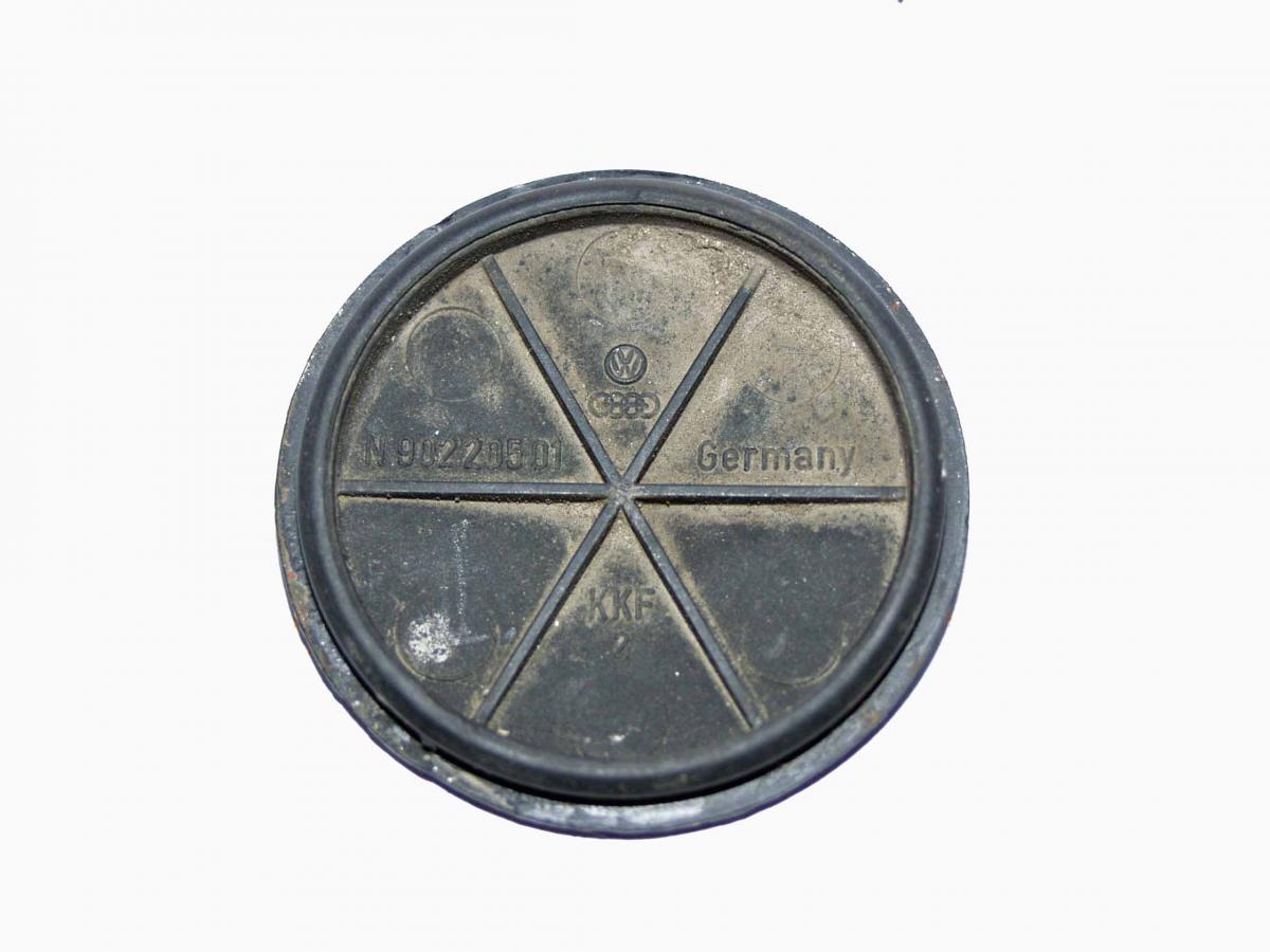

Are those small covers a VAG part?
I have similar but knocked them up myself.

Hi CFB, Yes they are VAG parts: Drain plugs off the front apron of golfs built between 1983 and 1992 part No. N90220501. I'm supprised you did not know! :giggle:

Apologies for resurrecting this thread, but I'm having problems fitting the caddy trims. Reading the above the trim should just click on over the bolts, but not in my case. Firstly they are the dome shaped caddy trims rather than the T5 trims since they are 5x112 bolting pattern.
I have removed the locking wheel bolt to make sure that wasn't the problem, but the trim just doesn't seem to click into place. It seems to be held of due to the outer diameter of the trim touching the wheel before the retention feature has clicked over the shoulder of the bolts. Even when I really push it won't engage. I have removed a bolt from the wheel and pushed it into the trim (off the car) and it cleanly engages so that all seems in order.
The wheel are skoda 7J steel wheels. Has anyone else had this problem?
