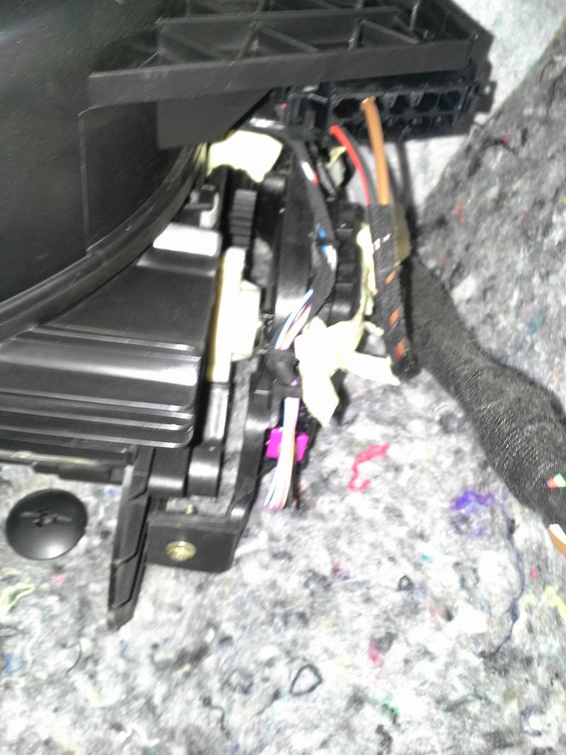

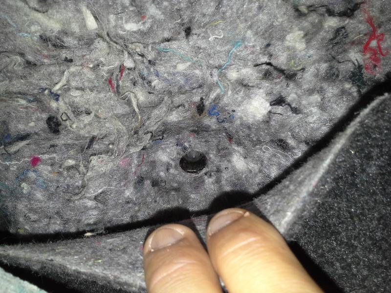

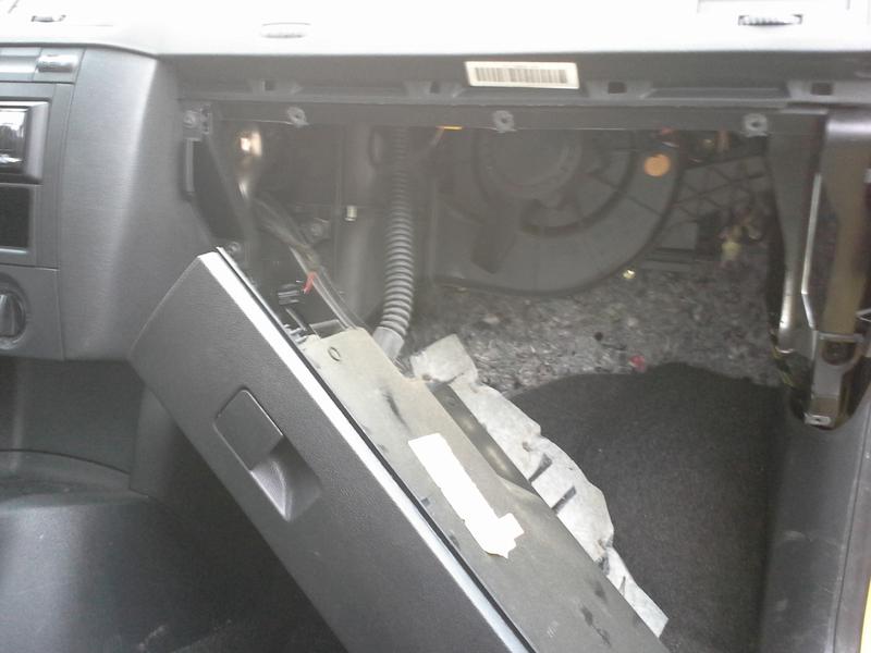

So, I have read about the glove compartment, and I've actually taken time to unscrew the thing and have a look behind it all. I'm still dazed and confused, though. I can't figure out where the cable should go. I have found two possible places, as you can see in my attached images.
First, it's this black plastic thing that you seem to be able to screw out. Is this what I should unscrew?
Second, it's this weird little sawed hole in the mattress, where you can see something that looks like the sharp edge on the end of a screw, where some black rubber (or plastic?) black padding is seen around the actual spike.
Am I on to something here, or totally in the blue?

Check the opposite side. Take down the trim from under the vent hole (where the light buttons are).
