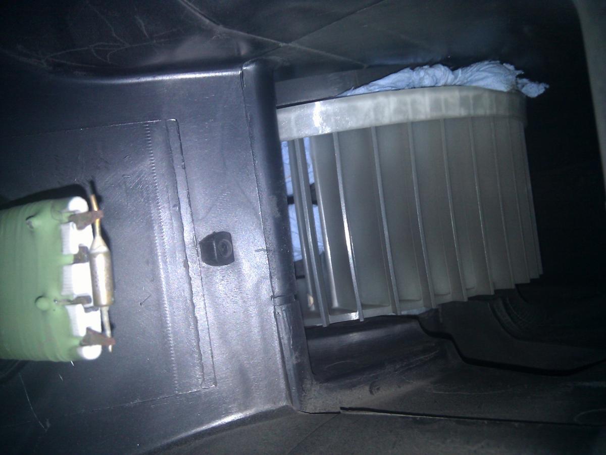

When I bought my Fabia, it had some blue paper towel stuffed under the glove box. I didn't think much of it at the time (probably should have done - don't shout at me!) as it wasn't a problem - until now! The pollen filter was recently replaced as part of a service, and I now have two problems that I'd like to sort out.
Problem 1: The air blower makes a lot of noise when turned on. I think this is due to some of the blue paper towel being trapped in the fan (see attached image). After searching rigorously on the forum, I've had the pollen filter out again, had the blower on all settings, in all positions and with recirc on and off - but the paper won't budge.
Question 1: Will removing the glove box (as mentioned in various threads on here) give me enough access to the fan to remove the paper that's stuck there?

Update!
I managed to resolve Problem 1. Taking the glove box out did give me enough access for what I needed. Once it was out of the way, the fan was open and accessible from the "rear" - the side closest to the engine. There was enough room to get my hand up and into the gap to pull out the remaining bits. Obviously the fan should be OFF before doing this!
I found it helpful to lie on my back with my head in the footwell looking up - either straight at the gap at the back or through the opening for the pollen filter. I used the flash LED light on my phone so I could see what I was doing.
