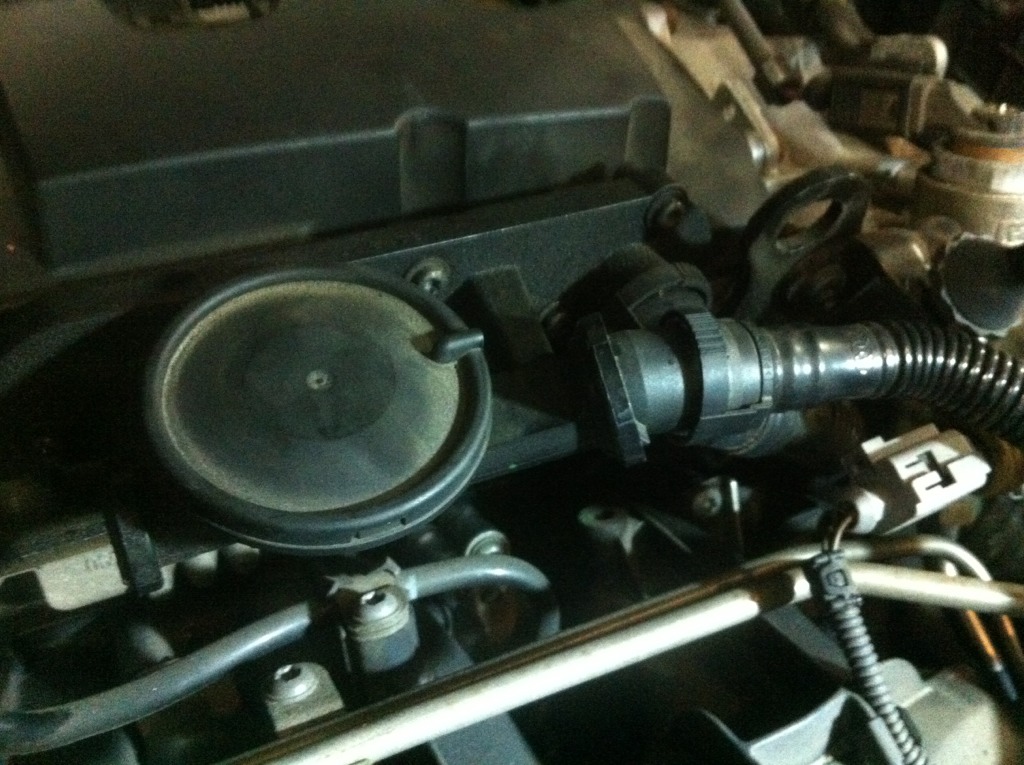

Had the engine cover off and I have heard air being sucked in through the pipe on the round black circle in the picture.
When I cover the small pipe on the right the engine struggles and stalls. It also sounds like a pop is coming from inside it.
