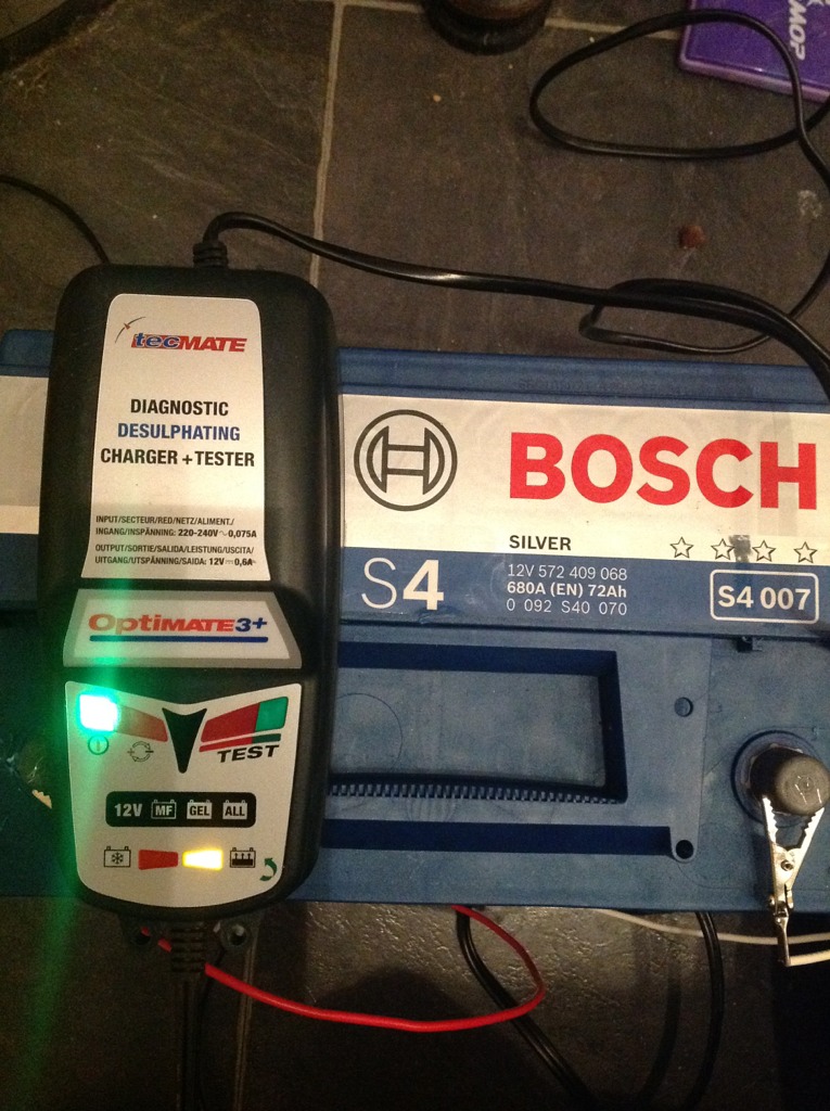

Hi everyone, so i got my hands on a Bosch S4 from one of my dads company vans, it was fitted in April last year then the van blew its engine in july and has not turned a wheel since, the battery was flat when i went to remove it and it reads 11.45 volts on my multimeter, currently have it hooked up to a maintenance charger.

Ok guys, i just checked the battery, its up to 11.8 volts and its been hours since i put it on charge, pretty much the same time i started the thread.
Is this battery past it
how do you mean up to 11.8v?
do you mean you've taken it off charge and let it drop to its float voltage?
No, its still charging, i was checking it. I was expecting 12.6V upwards
how does your charger work?
It should be charging 13v+. My ctek charges at 14.4v normaly, 13v in power supply mode and 14.4v but really low amps in recond mode
Im not sure exactly how it works, its my dads.

I have still got it on charge and we are up to 12.15V thats after 24 hours on charge. Anything else I can do, fit it in my car and go for a long run maybe? I have a big battery charger but its for fast charging, I can only imagine this would ruin the battery more.
just leave it charging mate.
Your car will not be able to charge it anyware near aswell as the charger.
Its set to slowly up the voltage as it charges. Its a wierd way of doing it but its how it works. My Ctek XS7000 took 5 days on a mates battery once to fully recondition it as it was very poorly
Dont use a fast charger, it will damage it more as you say.
O well here comes the long wait, I might sneak it into the office to save on the electric bill :think:
