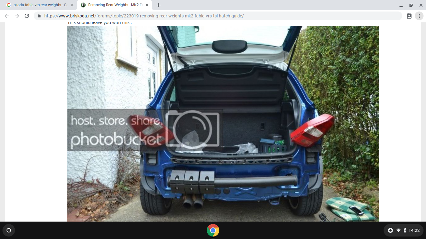

The MK2 Fabia vRS Hatch has a crash bar with 'ballast weights' on it to make the Unladen / Kerb weight 5kg more than the vRS Estate.
A Tow Bar can go on if you are not going to tow with it, but you are invalidating the insurance as 'Skoda' never submitted towing weights.
The 1.4 TSI Twincharger / DSG Polo, Ibiza & A1 sister cars can tow as VW, SEAT, Audi submitted towing weights.
They are sister cars with the same platform, engine / gearbox, brakes, suspension, different crash bar from the Fabia though.
