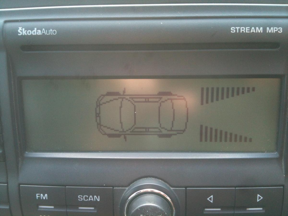

You can get OPS of sorts on the Stream. It only shows four corners of the car.
I'll post a picture if it in action if I can find it. It's certainly not a patch on the Bolero or Columbus (no idea about Amundsen).
Here's the Stream MP3 in action:
Ok so this is what I'm after, how do I go about fitting this and what do I need?

I'll post part numbers and links to kits later, but to be clear, mine was a Stream MP3. If yours is the standard Stream, I don't know if you can also get this.

Should it say "stream mp3" on the head unit?
Yes, the older ones just say "Stream"
In the picture I posted, it says 'STREAM MP3' in the top right. I believe the earlier ones just said 'STREAM' in the same location.
