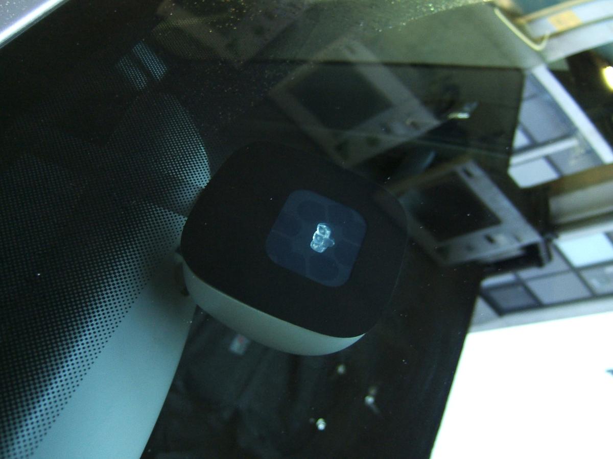

Here's a rain sensor btw, on a first gen Octavia I think. Looks pretty similar (if not identical) on the second generation.

This is what mine looks like.
