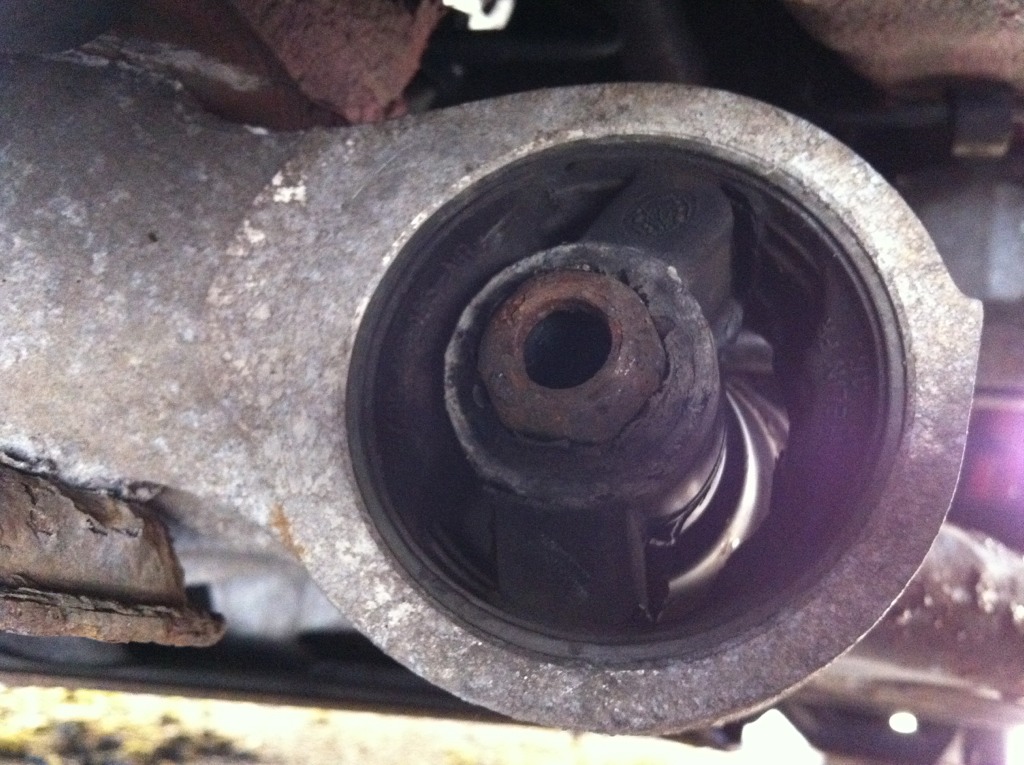

Have you looked at the console bushes, they're simple to check, if they look like the image below they're screwed. Check them by putting the car on full lock to the left and checking the right bush, do the opposite for the other side. If you've lowered the suspension you may need shorter drop links, ARB bushes tend to knock when cornering but again check them, it's easier when you have the wheel off.

aaah brilliant thanks guys, will check all these things. The console bushes look fine to me so i'll next check the arb bushes :) and the top mounts and bearings. Great help

yeah just looked at mine, they look exactly like this...sooo just wondered if you know if they're easy to change?? i know they're not too expensive and should i upgrade to the ibiza cupra ones?? thanks again!
I've got them on mine and although the transformation from the original shot bushes was fantastic, they do introduce more road noise through the cab below sort of 1800/1900 RPM. The standard ones have been improved now so I'd probably stick with them if I was replacing them again.
aaah too late ive ordered, still, i probably wont notice too much as the road is pretty loud anyway and ill be very happy to get rid of the constant knocking!!!
Personally I fitted Powerflex solid bushes as even with a mate in the trade offering to lend me the correct tool to press them out it was suggested that it could be a ball ache and the Powerflex versions are dead easy to fit. Some diesel owners have said they get more vibration but others don't. If you are going DIY then look in the technical guides section at the guide, very useful info in the thread.
