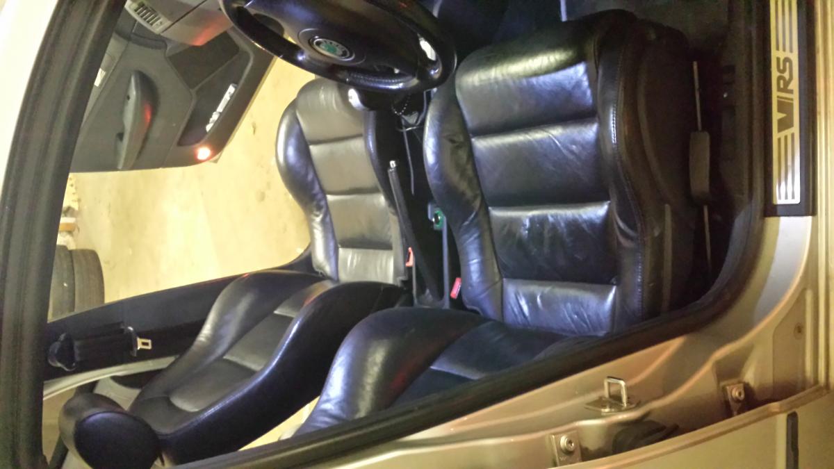

This may have been mentioned but if not I hope it helps. Audi TT front leathers will fit in a mk1 fabia. I have helped a friend install them and its not that much hassle. Just needs a bracket. If this is any help please let me know and I will post more info. It is just the two front leathers not the rear. Thanks uzzy

I follow pastyboys guilds and put octy half leather in my fabia all in cost me £200 and sold my vrs seats £140 so £60 after all and was really simple but they are less supportive than the standard vrs seats but easier to clean kids dirty shoe marks off the backs
