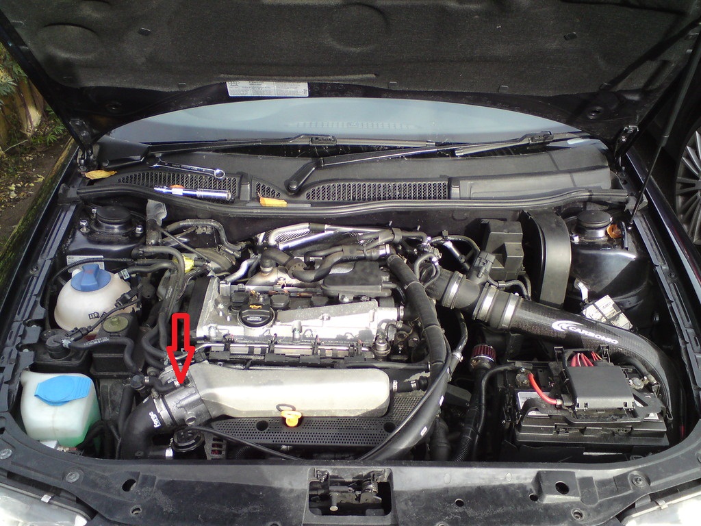

So is the vac line to the carbon can the one in the pic that rob has put up??

They all some from the inlet but having a leak the 4mm line going to the fpr is going to have a much bigger effect of your fuel pressure than a leak on something else. Basically a leak directly on the fpr hose will completely stop it from working but a leak elsewhere wont.
And no that pic is of the fpr line
Id take it from here personally but there are lots of other places that don't involve the fpr
