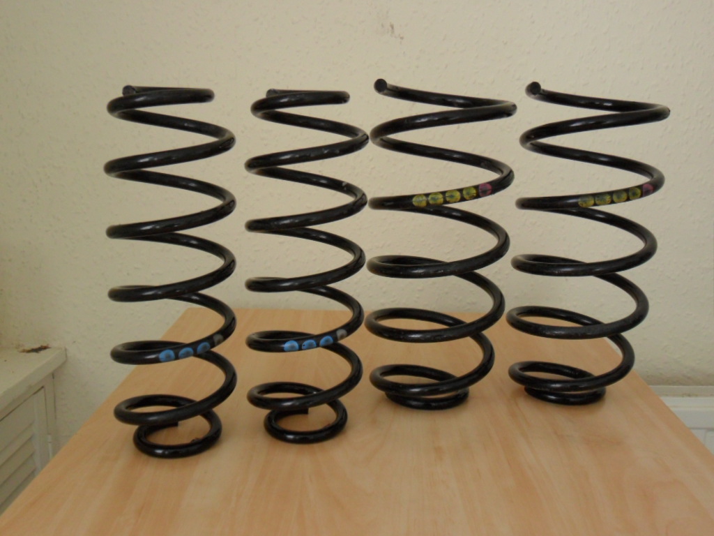

Looks as if you have bought MK2 Octy springs, if the box was marked up 1Z Octavia, the springs in the E-bay ad look different to the springs I have just sold, here is picture of the set I just sold
Hope this helps.
