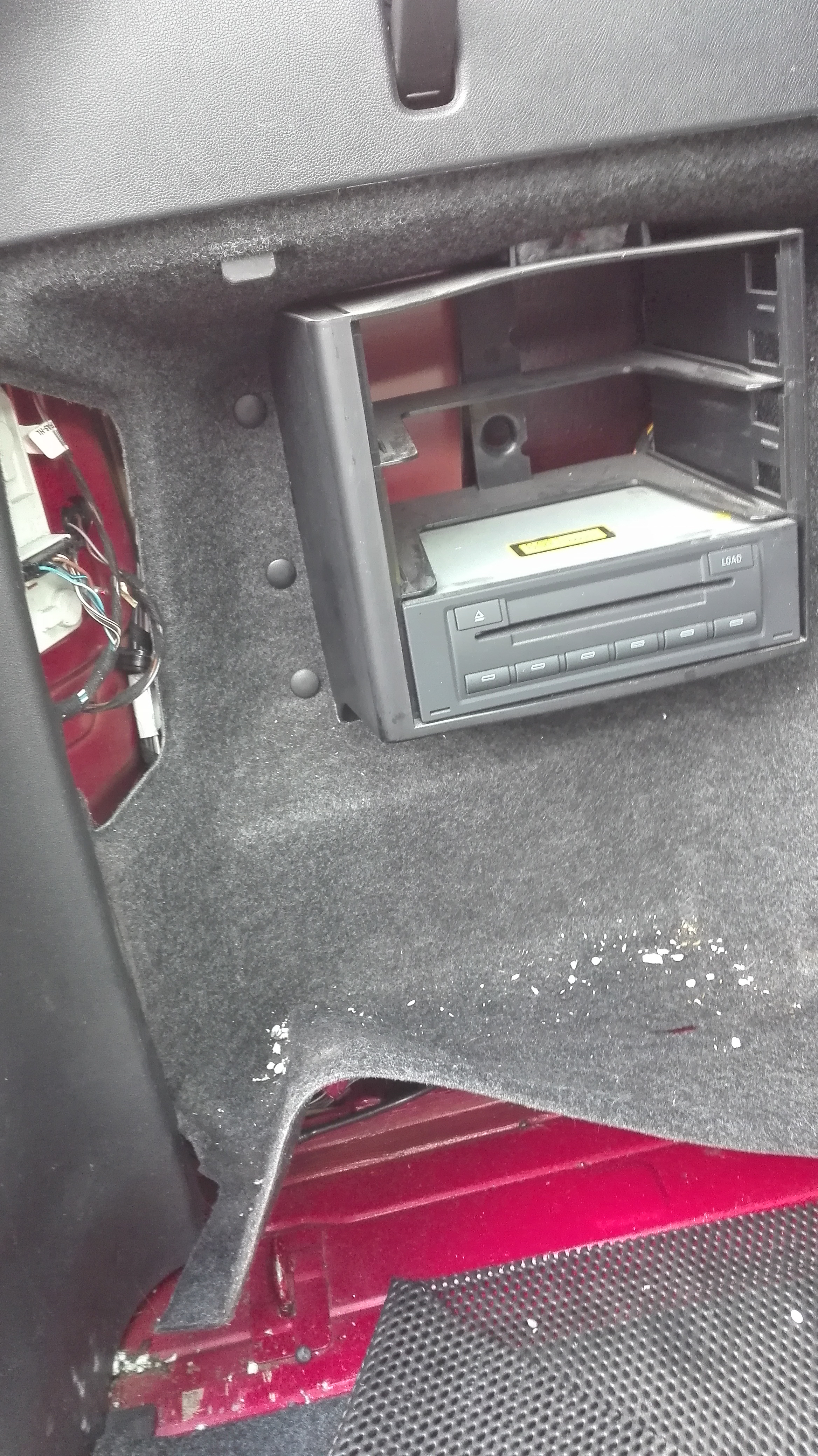

Would be very grateful for detailed instructions on how to get behind the CD multichanger, carpet, trim, etc, to inspect the joint in the the feed pipe that is said to be there. For information the rear wash does not deliver water, the pump can be heard running, and the jet is definitely not blocked.

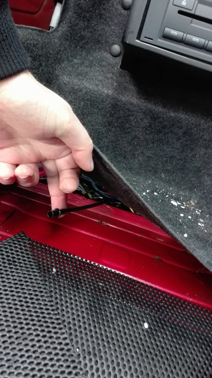

See my picture I had the same issue. And probably it's happened after I changed the bulb on rear light

Hi. Fascinating, thank you. Is there a pipe connector somewhere near the bottom of the A pillar on the passenger (RHD) side? I suspect that’s where I have the problem with my son’s car, which has caused issues with the heater resistor and blower. The heater is resolved but currently he’s under orders not to use the rear washer spray. If there is a connection there, I can’t work out how to get to it to reconnect (or bypass). Any knowledge shared most welcome.
