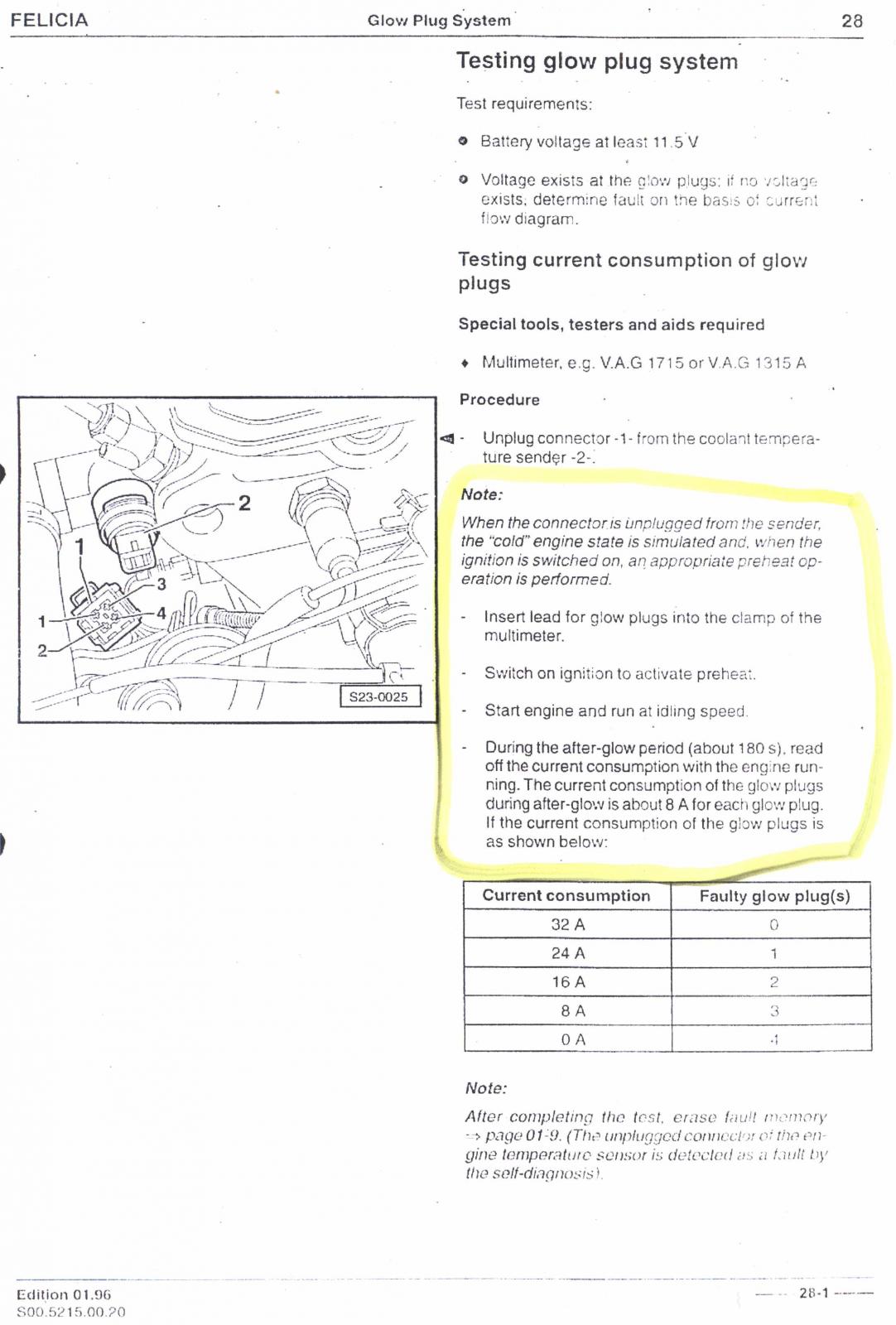

The glowplugs are on for upto 180 seconds after the engine starts. Usually, they turn off if the rpm goes over 2500 but come back on when the rpm falls below 2500 again. You can sometimes hear the glowplug relay clicking on and off.

The afterglow period is definitely 180s with the engine temperature sensor disconnected. The ECU controls the glowplug relay.

Where did you read that Wikipedia? Put a volt meter across the glow plug buss bar if you don't believe me.
The later ones certainly have a 180s afterglow period. I've grabbed the Felly manual and it seems to agree.
glow plugs are only there to start them on felicia i had a polo deisel with same engine and ecu that never came on after it was started cold none off this 180s
