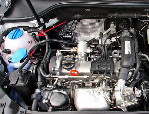

Hi All, the rattling noise from the passanger side dashboard at Fabia II 1,2 TSI 63/77kW engines comes from the fuel pipeline. At the low idle speed 650-750 RPM this pipeline takes resonance frequency and rattle in the pipeline tunnel. This has been observed on many Fabias since 2010 and solved in authorised services SKODA by some absorbing sealing pushed in to the pipeline tunnel close to the front windshield washer tank. Please look in the attachment, where the black plastic sealing is placed. Regards Jiri, (Czech Rep.) I'rve just bought 3yo Fabia 2010 and got it already solved from previous owner and authorised service Skoda.
