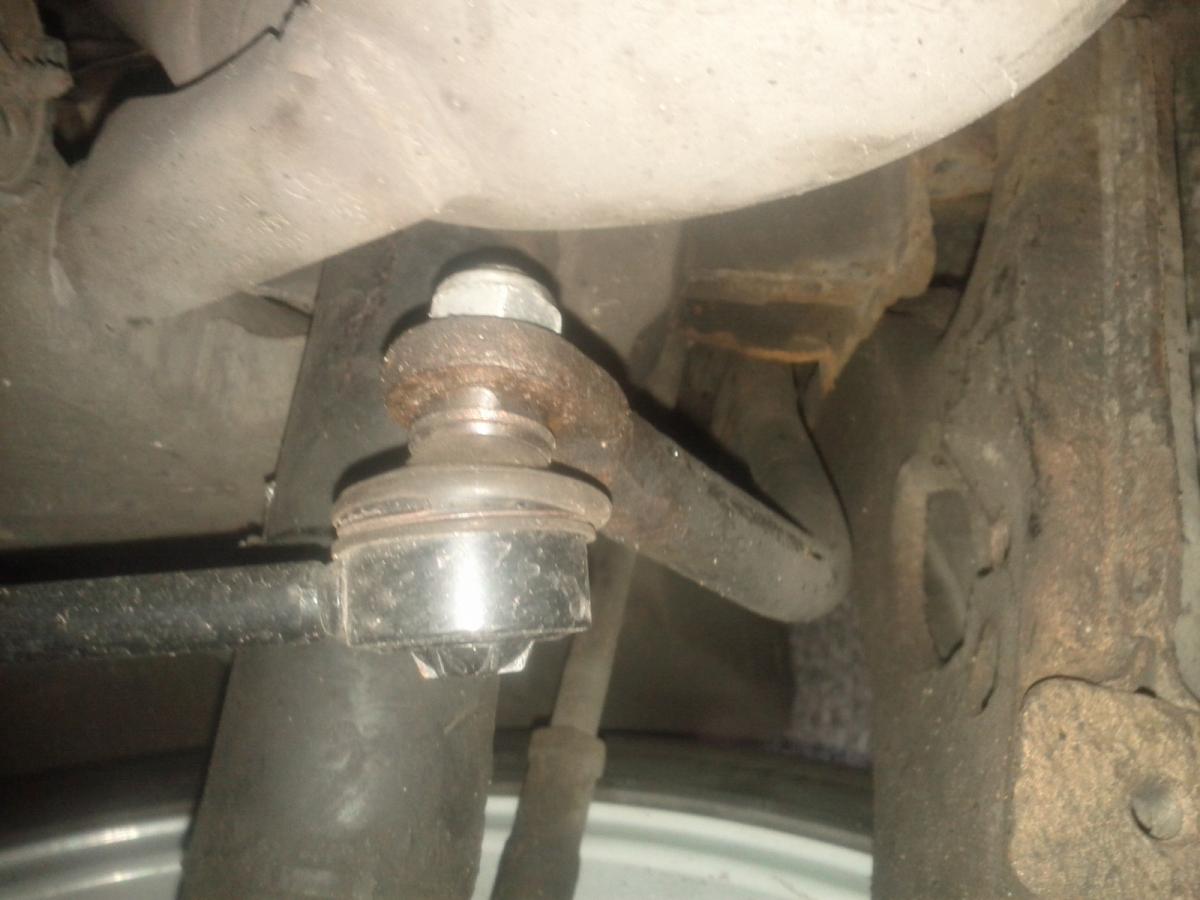

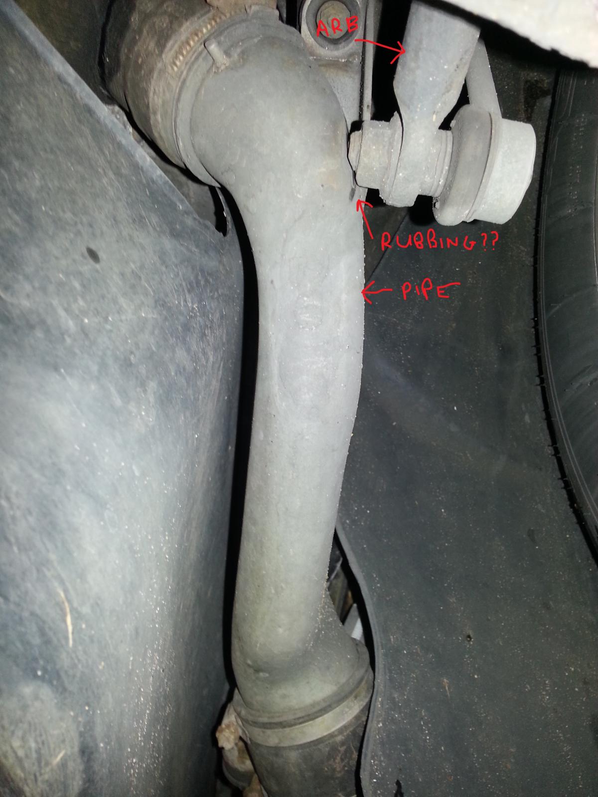

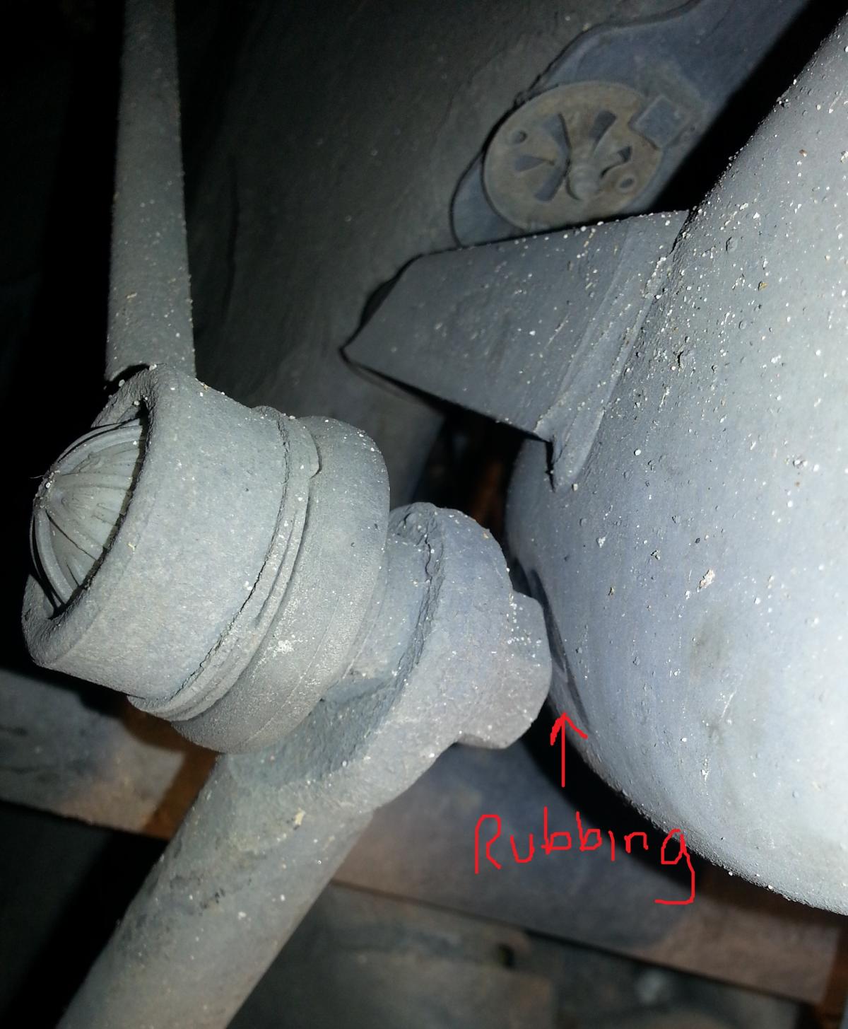

Ok thanks for your help on this. Have ordered new bushes from vwsonline and should hopefully be with me by Wednesday. I'll get them fitted and let you know how I get on. When I was looking at my bar I noticed that it appears to br rubbing on the oil cooler pipe?? Or at least I thinm thats what it is. Anyone else got this?
Will try and get a pic to show what I mean
Don't know what that pipe is from what I can remember there is no pipe or hose near mine. There is a few clipped into plastic holders around that area maybe one of them is snapped and the hose is hanging down. Try posting a picture up.
Its not a hose its rubbing on. Sorry, getting to grips with engine parts. I'll get a pic up
Hope you can see the pic ok. This is taken underneath the car looking up. This photo is more to show the pipe that the ARB bolt, where it joins to the drop link, is rubbing
This is to show from the side/frontish. Excuse the 3 year old writing :yes:
Any ideas why it is doing this??
That doesn't look too good. I'll take a look at mine tomorrow see where my arb links are in relation to that pipe. The first pic looks like a turbo pipe. My first thought there was your arb links could be too short and making the bar sit too high.
Cheers. Its on drivers side and you should be able to see it by just turning the wheel to move it out the way
Right I've had a look at mine this morning.
It was hard to tell of your first photo but I think its the pankake
pipe. That goes to your intercooler which you can't see as its hidden
behind the arch liner. Your link and roll bar seem to be at the right
height but it looks like the bar somehow has moved across to the
passenger side. On mine there is maybe half inch gap. Its probably
due to either broken plastic collars allowing the bar to move sideways
worn bushes, or both. Remove arb brackets, knock the plastic collars off
fit your 17mm bushes but pull the the bar back across more to the drivers
side so you have a gap like mine. Refit your brackets job done. It should be
fairly straight forward. Hope this helps.

Both those pics are showing your intercooler pipe(pancake pipe) named due to it's flatness. It is coming from your front bumper intercooler flexi pipe then routes up behind engine to the turbo via bunch of solid pipes and flexi hoses.
The only time I have seen the metal pancake pipe get hit was on mine when I lowered my car a lot and the extra screw thread coming from the drop link ball joint was hitting the pipe. I angle grinded off the extra thread. :rofl:
As your drop link is actually very close to the pipe my guess is your ARB has lost it's plastic sleeving either one end of ARB or both ends,  which is allowing the whole ARB to slide more one side. (the sleeves butt up to the ARB brackets and stop side to side movement)
I bet if you check the other wheel your drop link is miles out.
Or as someone has stated someone has fitted a none 1.8T drop link of different length(should be 336mm ball joint to balljoint centers) :thumbup:
