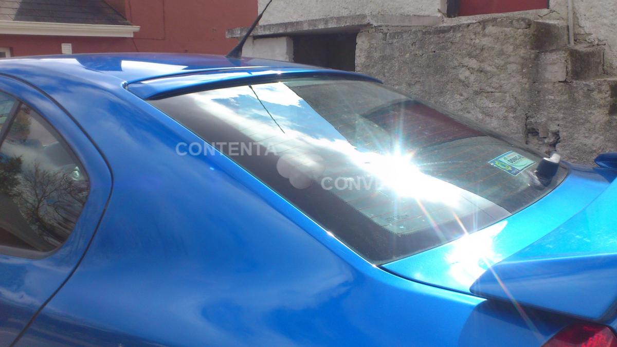

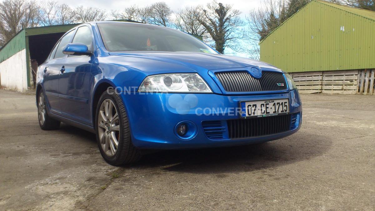

pardon the poor photos was in a rush and the car is in need of a good detailing, im replacing the original badges with the new look badge and im in the process of taking it apart and carbon wrapping the black part in carbon wrap so should look nice. anybody know how to remove the boot badge? is it held with just tape or is it fixed with two studs also?
Rear badge is just stuck on, there are 2 legs on it, but if you use a bit of fishing line and work your way round it comes off handy
What new rear badge did you order? i have ordered a fabia one but its on back order so waiting for it to arrive
Front grille looks well though :thumbup:
Did u just paint the vrs badge black? Been thinking about doing this myself but I am not exactly the mist intricate when it comes to fiddly jobs.
Sent from my GT-I9300 using Tapatalk 2
The rear badge number ends in 603 not sure what its off but its slightly over sized for the back. Havnt put it on yet as I must remove the old badge first.
The badge I took apart and carbon wrapped the plastic then put thechrome back on. I like it. Not a hard job really you can prise off the outer chrome rim using your thumb and a Stanley blade. The same for the centre. And its just snaps back into place with a little persuasion!
