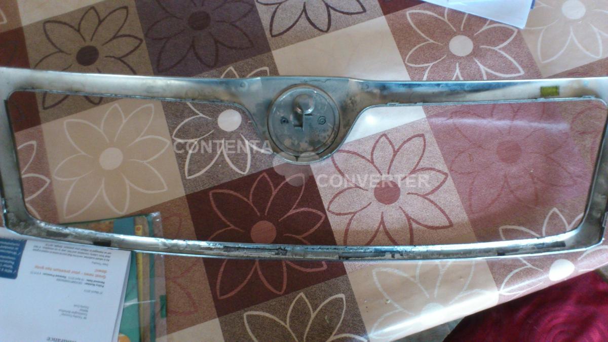

I painted the grille on my FL vrs myself just gave the chrome finish a good rub down with wet and dry and a few coats of plastic primer then a few coats of Race blue followed by a few coats of clear. I ordered a spare chrome surround and grille so I can return it to normal if I choose to.

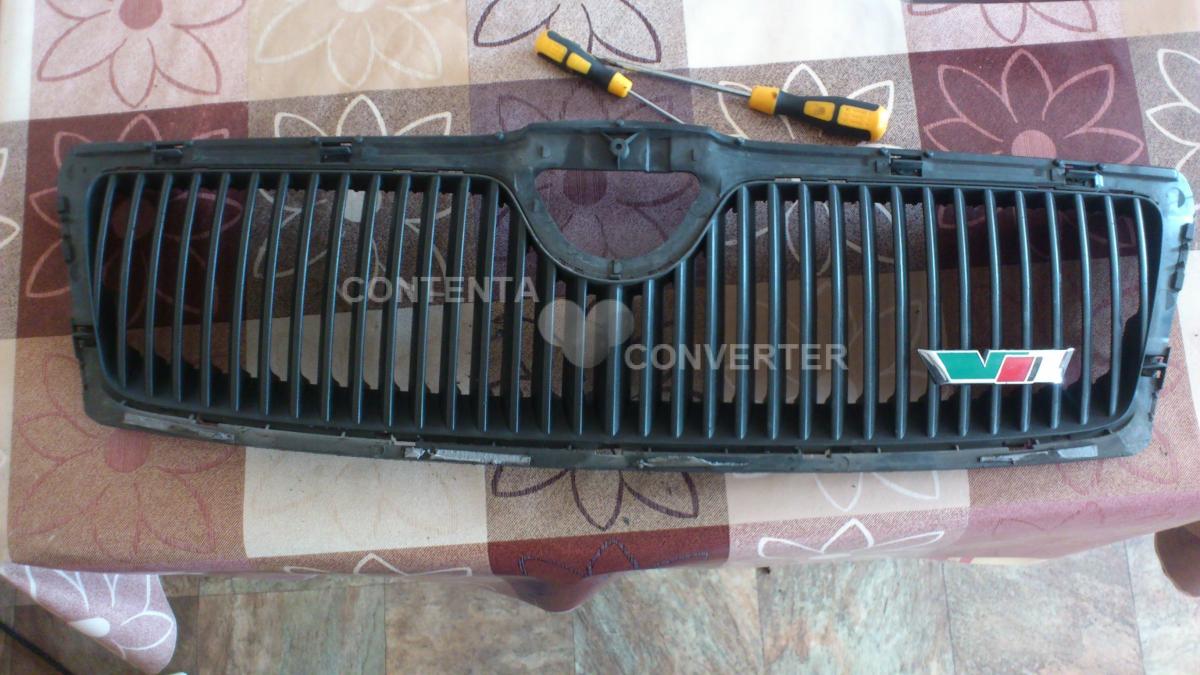

Ok, after failing to find help online I decided to tackle the grille myself, so here's how i go on WITH PICTURES!! :-)
removing the chrome surround was ok with a little care and some small flat head screw drivers i worked it off the only issue you may have is with the bottom of the grille its attached with four pieces of double sided tape. but again with a little care its not an issue.

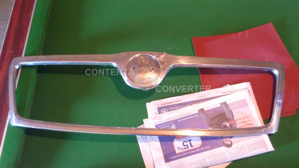

the reverse of the chrome surround....

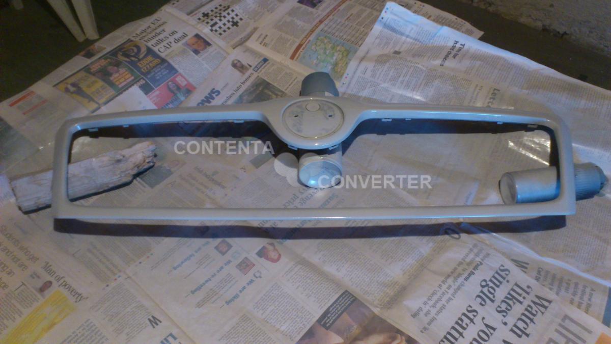

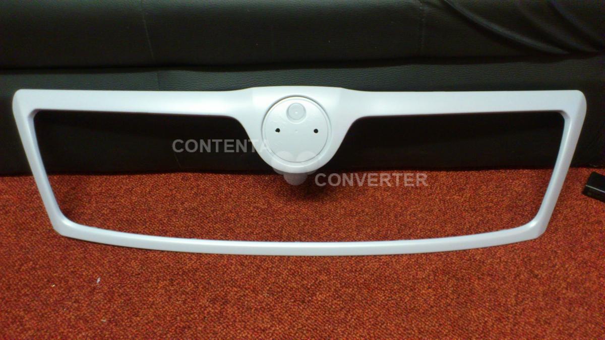

hand sanded it with 400 paper and because my local motor factor was out of plastic primer i just shot it with grey primer 3 good coats a light wet sanding and another coat of primer and its off to the painter in the morning as i'm painting the lower grills and bought a rear milo tech roof spoiler so he's doing the lot. just had a quick look and the primer is perfect.
ready for paint in the morning...

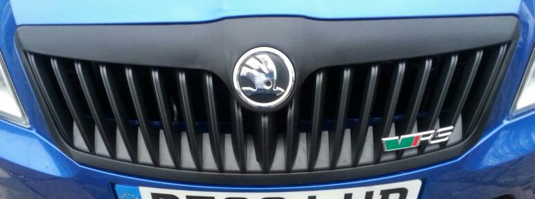

pardon the poor photos was in a rush and the car is in need of a good detailing, im replacing the original badges with the new look badge and im in the process of taking it apart and carbon wrapping the black part in carbon wrap so should look nice. anybody know how to remove the boot badge? is it held with just tape or is it fixed with two studs also?
