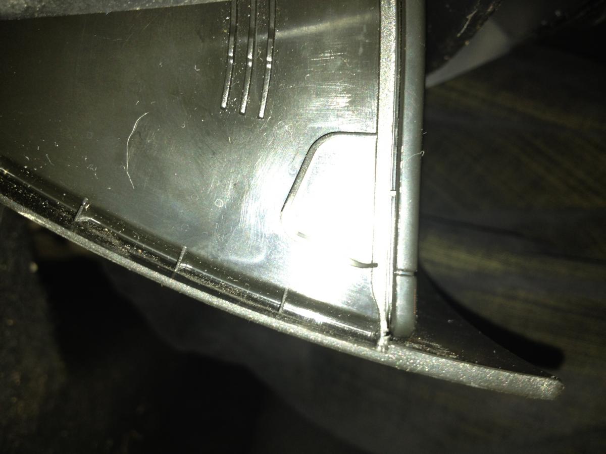

Just been and had a look for you and there is a triangle of plastic on the storage bin (both sides) near the top leading edge.
(Poor picture. Sorry. This is the left side of the bin. The top of the bin is on the right of the picture and the back of the car towards the bottom of the picture. Imagine the picture rotated 90 degrees anti-clockwise and it will make more sense.)
When closing, these provide a slight friction fit against a thin plastic strip/bar I side the armrest housing.
It's not much and if the housing hasn't been put back quite right, I can see that 1mm extra gap and a bumpy road would easily cause it to fall open.
