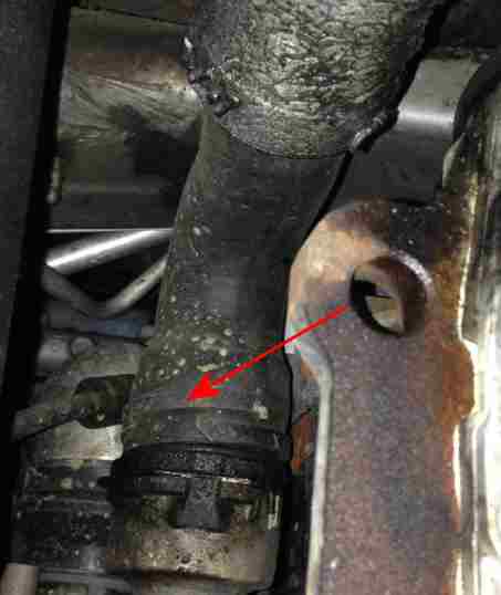

Today I went to do an oil and filter change and noticed the bottom intercooler hose was absolutely covered in oil at the join.
I removed the undertray and noticed that the metal intercooler hose was also covered in oil.
You can also see that the outlet of the turbo has oil around the join to the boost hose. This next picturemay show it a tad more clearly:
The car drives perfectly. No smoke at all (that I can see) when driving. None of my friends have mentioned it when following (all car nuts too so would have said). The pictures look pretty conclusive to me that the seals have gone / are going.
What do you guys think? Is it normal or?

That hose is almost off and you are missing a clip - you can see where it was
The clip is on there mate. It's just very difficult to see in the picture.
That's how it fits. I checked mine the other day and thought it was a weird setup as it looks like it's coming off. Have you got loads of play with that pipe where it goes into the turbo? Mine didn't have a lot oil over mine though

I had it all apart today. A tiny drip came out of the bottom pipe to the intercooler. At most a teaspoon full. So I don't think it is anything to worry about at all.
And with regards play in the pipe connected to the turbo, there is loads yeah.
We stripped down a friends vrs and his was exactly the same so I'm happy.
