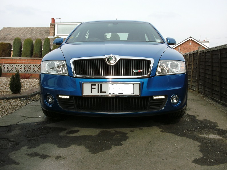

Just got my "new" motor last week, and have fitted these...
http://www.ebay.co.u...T-/251106920629
Pic doesn't do them justice, but IMHO they do look really good and are very easy to fit...
