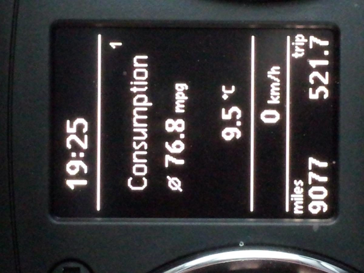

Drove back from Carlisle to Lincoln yesterday - 182 miles, 3hrs 12mins, average speed 57mph
Average fuel figure on maxidot.......
Pretty good. If you deduct 10% you'll end up with a more accurate figure. Better still, brim the tank, drive till empty, return to full and then calculate the litres consumed to give your mpg figure.
My Superb Combi is recording 65.20mpg at present which is excellent considering the size of car.

I am consistently getting 600 miles per tank since having the tuning box on (A road and a little dual carriageway 35 mile round trip each day) - previously I was getting around 520-540 per tank.
Did a stint down the M5 not so long back and it was reading 71mpg at a steady 70/75.
I'm hoping once I've got a few more thousands on the clock it will increase further - currently on 5k.

Mine varies depending on the driving. I've just done over 8000 miles and so far my best tank is 76.08, the worst is 40.52. Still from what I'm told the engine isn't really run in till past 10K.
