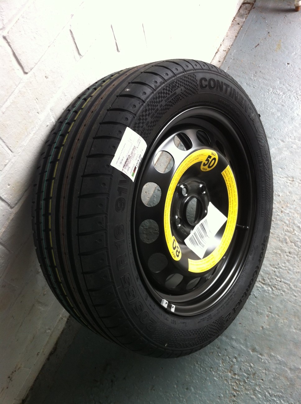

Just took delivery of a proper spare wheel and tools (jack & wheel brace etc) for my Octavia vRS Blackline which came with a crappy pump and sealant gunge as standard.
I think its not at all bad value at £131 inc the V.A.T. as I was expecting a very narrow space saver wheel so when a 205/55 Continental Sport Contact 2 shod wheel turned up I was well chuffed.

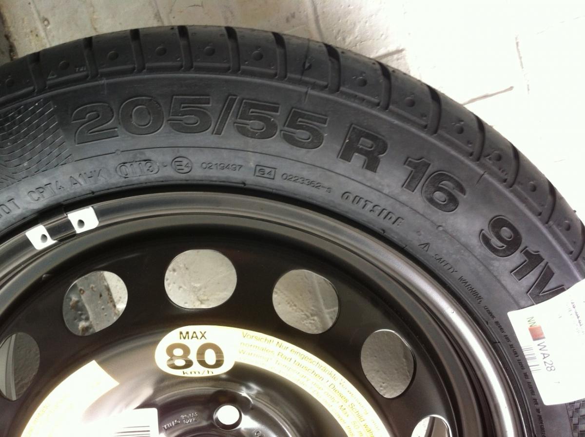

Question: the standard wheels are 225/40 x 18, the spare is 205/55 x 16, is this correct? The overall diameter does look more or less the same.

Yep, tyre sizes are correct, they have the same rolling radious
Hell that was quick, cheers for that mate.

I did the same :thumbup: only downside is you'll be limited to 50 as it's a different sized tyre on the same axle :'( better than the gunge alternative tho :rofl:
You've got the 16" rim which will fit over the vRS front calipers (just) if you had the 15" you'd not be a happy chappy as they foul..... apparently!

..................and the tyre is asymmetrical so it will fit on any corner
