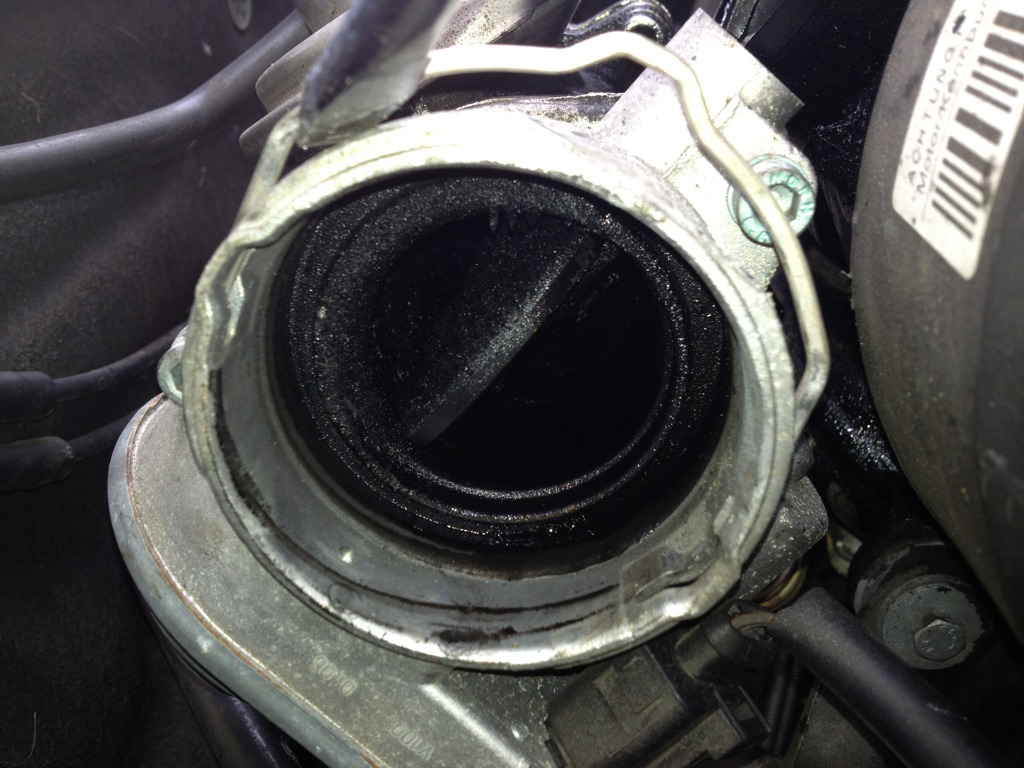

post-101687-13667897311551_thumb.jpg Is this right?

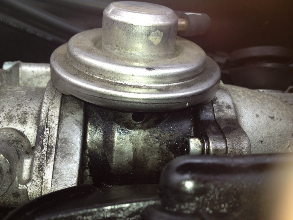

I just cleaned out a load of crud out of my egr and can't find any burst pipes
How secure are the connections?
When I first got my vRS, the pipes were connected, but they opened up slightly under load. Visually they looked fine apart from the oil seeping around the join.
How do I resolve that
